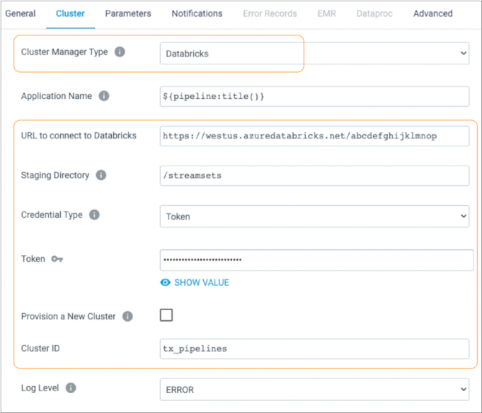

The following image displays a pipeline configured to run on Spark deployed to an existing Databricks cluster on Microsoft Azure:

You can configure a pipeline to run on an existing Databricks interactive cluster.
When a Databricks cluster runs a Transformer pipeline, Transformer libraries are installed on the cluster so they can be reused. Pipelines from different versions of Transformer cannot run on the same Databricks cluster.
For example, say you have a cluster that previously ran pipelines built on Transformer 5.8.0. When you build new pipelines using Transformer 6.3.0, the new pipelines cannot run on that cluster.
In this situation, you can run the pipeline on a different existing cluster or configure the pipeline to provision a cluster. If the existing cluster no longer runs pipeline from the older Transformer version, you can uninstall the older Transformer libraries from the cluster and use the cluster to run pipelines from the newer Transformer version.
To run a pipeline on an existing Databricks cluster, clear the Provision a New Cluster property on the Cluster tab, then specify the ID of the cluster to use. You must configure any extra Spark configuration properties in Databricks. This requires you to restart the cluster. For details about specifying Spark configuration properties, see the Databricks documentation.

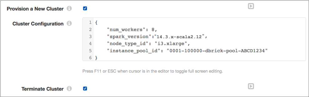

Using an Instance Pool
When you configure the pipeline to provision a new Databricks cluster, you can have the provisioned cluster use an existing instance pool.
To have the provisioned cluster use an instance pool, include the Databricks instance_pool_id property in the Cluster Configuration pipeline property, and set it to the instance pool ID that you want to use.
For example, the following set of properties provisions a cluster to run the pipeline that uses the specified instance pool, then terminates the cluster after the pipeline stops:

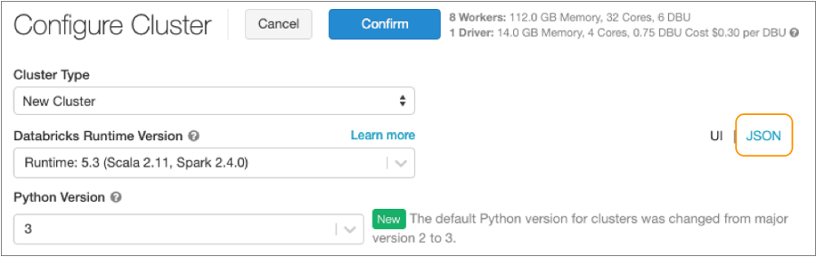

To locate the valid cluster configuration property names and values, launch your Databricks workspace and view the properties used to create a job cluster.

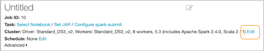

  1. In the side bar of the Databricks Workspace, click the Jobs icon and then click Create Job.
  2. In the job details page, click Edit next to the cluster specifications:
  3. In the Configure Cluster page, select the desired values, and then click JSON to view the specifications in JSON format.

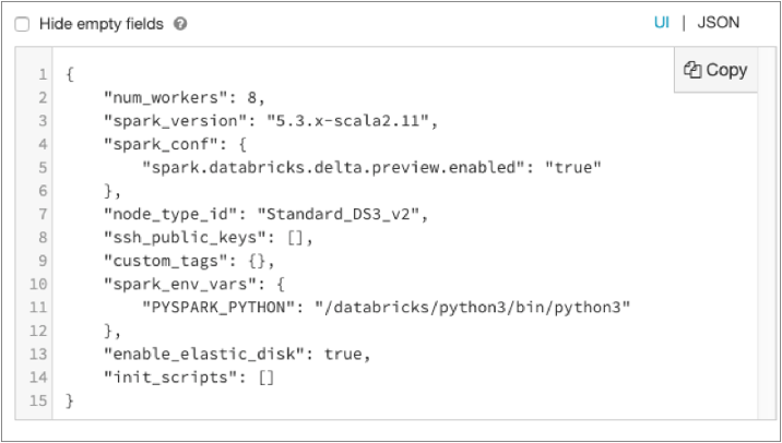

    Important: Be sure that your selections meet the minimum requirements for Transformer.
    The following image displays a sample cluster configuration in JSON format:

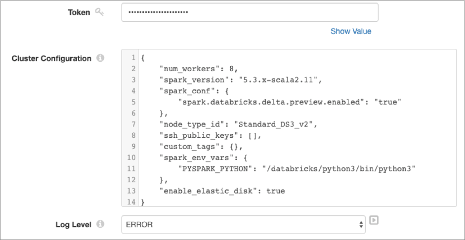

    Use the property names and values displayed in the JSON page to define the cluster configuration properties and values for a Transformer pipeline. You can add all properties except for init_scripts to a pipeline cluster configuration.
    For example, the following image displays the Cluster Configuration property for a Transformer pipeline. The property contains the entire JSON for the job cluster, with the init_scripts property removed:
