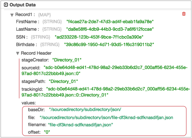

Viewing Record Header Attributes
You can use data preview to view the record header attributes associated with a record at any given point in the pipeline. To view record header attributes, enable the Show Record/Field Header data preview property.
For example, the following image shows a record generated by the Directory origin in data preview.
An     output data page with the record header list and values highlighted
The "Record Header" list displays the set of read-only internal attributes in the record at this point of the pipeline. You can use the record.<header name> variable to return values for these attributes.
The header attributes under "values" are the attributes created by the Directory origin. You can use the record.attributes variable to return or modify these attributes. When you use the record.attributes variable to create a header attribute, it displays in this location during data preview.
