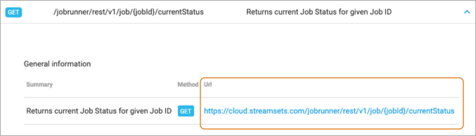

Finding the URL to a Control Hub REST API
Each Control Hub REST API has a unique URL. The URL contains the Control Hub URL and the path to the API.
You can find the URL in Control Hub.
  1. From the Help menu, click RESTful API.
    The page lists the APIs by category.
  2. In the list of APIs, expand the API to view API details, including the URL.
    URL displayed in API details

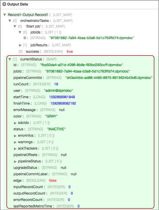

Generated record
The Control Hub API processor updates the orchestration record that it receives with the response from the Control Hub REST API. The response is placed in the output field specified in the stage properties. The fields included in the response depends on the API that the Control Hub API processor calls.
For example, the following preview shows the currentStatus field that was added to the orchestration record by the Control Hub API processor. The field contains the response from a currentStatus API call. The call requests the status of the job that completed earlier in the orchestration pipeline and returns additional information about the job:
Preview showing the currentStatus field added to the orchestration record
