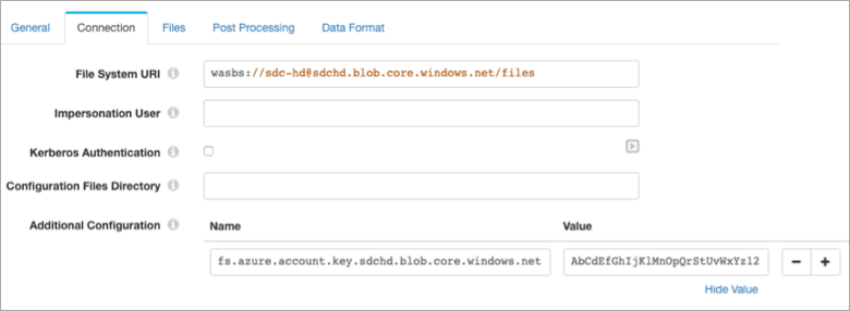

  3. On the Connection tab, configure the File System URI property as follows:
    <wasb[s]>://<container name>@<storage account name>.blob.core.windows.net/<path to files>
    In the URI, <container name> is the Azure container name, and <storage account name> is the Azure storage account name.
    For example, for a sdc-hd container in a storage account named sdchd, with all files in a files directory, you would define the file system URI as follows:
    wasbs://sdc-hd@sdchd.blob.core.windows.net/files
    Tip: You can find the container name and storage account name on the Essentials page in the Microsoft Azure portal. For a standard storage account, in the Microsoft Azure portal, click All Resources > Storage Account > Overview > Blobs. For a blob storage account, click All Resources > Storage Account > Overview.
    The page shows the container name and storage account name:
    Essentials page with the container name and storage account name highlighted
    Though the host name for the file system URI is <storage account name>.blob.core.windows.net, you can alternatively use the host name of the Azure blob service endpoint as the host name for the file system URI.
Example
The following image shows how to configure the Hadoop FS Standalone origin to read from Azure Blob storage with HDInsight using the Azure account information from the examples above:
Hadoop FS Standalone origin connection properties page

  2. On the Connection tab, configure the following properties:
    Connection Property Description
    File System URI Optional HDFS URI.
    When not configured, the stage uses the URI defined by the fs.defaultFS property in the core-site.xml file.
    Impersonation User The HDFS user to impersonate to access HDFS. When using this property, make sure HDFS is configured appropriately.
    When not configured, the pipeline uses the currently logged in Data Collector user.
    Not configurable when Data Collector is configured to use the currently logged in Data Collector user. For more information, see Hadoop Impersonation Mode in the Data Collector documentation.
    Kerberos Authentication Uses Kerberos credentials to connect to HDFS.
    When selected, uses the Kerberos principal and keytab defined in the Data Collector configuration file, $SDC_CONF/sdc.properties.
    Configuration Files Directory Location of the HDFS configuration files.
    For a Cloudera Manager installation, enter hadoop-conf. For all other installations, use a directory or symlink within the Data Collector resources directory.
    You can use the following configuration files:
    • core-site.xml
    • hdfs-site.xml
    Note: Properties in the configuration files are overridden by individual properties defined in the stage.
    Additional Configuration Additional HDFS properties to pass to HDFS. These properties take precedence over properties defined in Hadoop configuration files.
    To add properties, click Add and define the property name and value. Use the property names and values as expected by HDFS.
