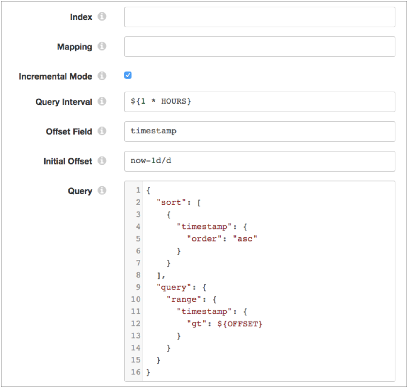

Incremental mode query
If you configure the origin to use incremental mode, you must include both the offset field and the offset value in the Elasticsearch query. Use ${OFFSET} to represent the offset value.
For example, let's say that you do not define an index, configure the origin to use incremental mode, and configure the timestamp field as the offset field. You use the Elasticsearch date math expression now-1d/d to set the initial offset value to one day before the current time. You include the offset field and offset value in the query to determine where to start reading data. The query properties are configured like so:
Elasticsearch origin properties page
When you run the pipeline, the query returns all documents that have a timestamp field with a value greater than one day before the current time. The query sorts the results by timestamp.
