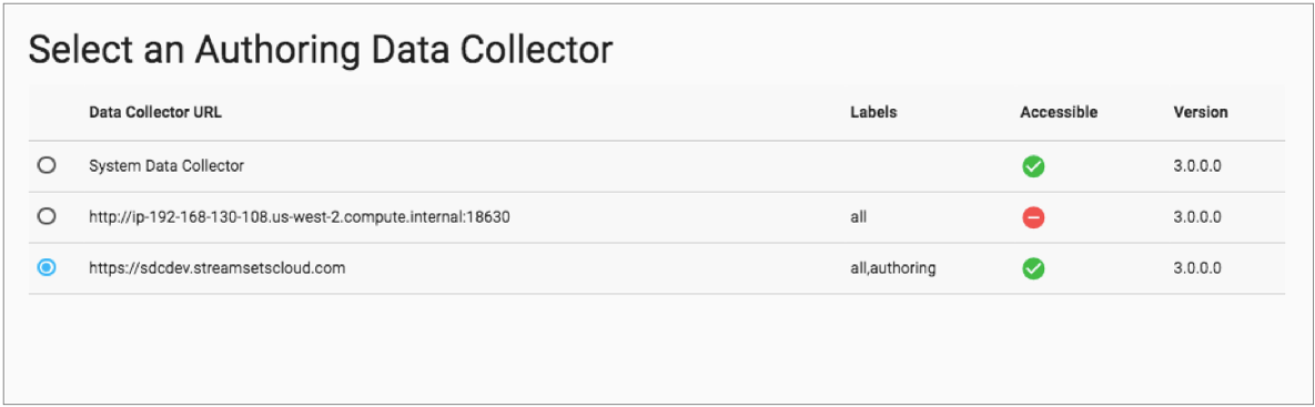

For more information about how a registered Data Collector works as an authoring Data Collector, see Registered Data Collector.
Note: Control Hub includes a system Data Collector for exploration and light development. Administrators can enable or disable the system Data Collector for use as the default authoring Data Collector in Control Hub. For more information about how the system Data Collector works as an authoring Data Collector, see System Data Collector.
For example, the following Select an Authoring Data Collector window displays the system Data Collector and two registered Data Collectors as choices for the authoring Data Collector. Notice how the second registered Data Collector listed in this image is not accessible and thus cannot be selected because it uses the HTTP protocol:

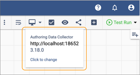

When you edit a pipeline or fragment in the pipeline canvas, you can change the authoring engine as long as you select the same engine type. For example, when editing a Data Collector pipeline, you can select another authoring Data Collector. You can cannot select an authoring Transformer.
Click the Authoring icon () in the top right corner of the canvas to view which authoring engine is being used and to optionally change the selection.
For example, the following image shows the currently selected authoring Data Collector:

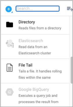

The stage library panel in the pipeline canvas displays all stages. Stages that are not installed on the selected authoring engine appear disabled, or greyed out. For example, the following stage library panel indicates that the Elasticsearch and Google BigQuery origins are not installed:
Stage library panel indicating that the Elasticsearch and Google BigQuery origins are not installed

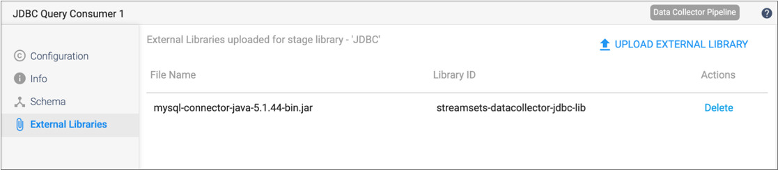

As you design Data Collector or Transformer pipelines, each stage requiring an external library displays the currently installed libraries in the External Libraries tab in the stage properties panel.
For example, the following image shows that a MySQL JDBC driver is installed for the JDBC stage library on the selected authoring Data Collector. As a result, this external library is available to the JDBC Query Consumer origin during pipeline design:
External library available to the JDBC Query Consumer origin during pipeline design

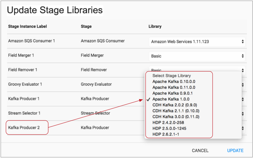

Update stage libraries for the pipeline
When editing a pipeline or pipeline fragment, you can use the Update Stage Libraries dialog box to update the stage libraries for multiple stages in the pipeline or fragment.
This allows you to update all necessary stage libraries at one time when you change the authoring engine for the pipeline or fragment. When preferred, you can also change stage libraries individually by editing each stage.
The stage libraries that display for each stage depend on the authoring engine selected for the pipeline or fragment. For example, if the authoring Data Collector has the MapR 6.0 and 6.1 stage libraries installed, then these are the stage libraries that display for a MapR FS destination or MapR FS File Metadata executor.
To update multiple stage libraries at one time, click the More icon (More icon), then select Update Stage Libraries.
The Update Stage Libraries dialog box displays the stage name and type for each stage in the pipeline or fragment. On the right is the corresponding list of stage libraries for the stage that are available on the authoring engine.
Update the stage libraries as needed, then click Update to save your changes.
Updating the stage libraries for each stage

  7. Select the authoring Data Collector or Transformer to use, then click Create.
    Control Hub opens a blank canvas or the selected sample pipeline.
If needed, you can change the authoring engine for the pipeline using the Authoring icon: .

If needed, you can change the authoring engine for the fragment using the Authoring icon: .
