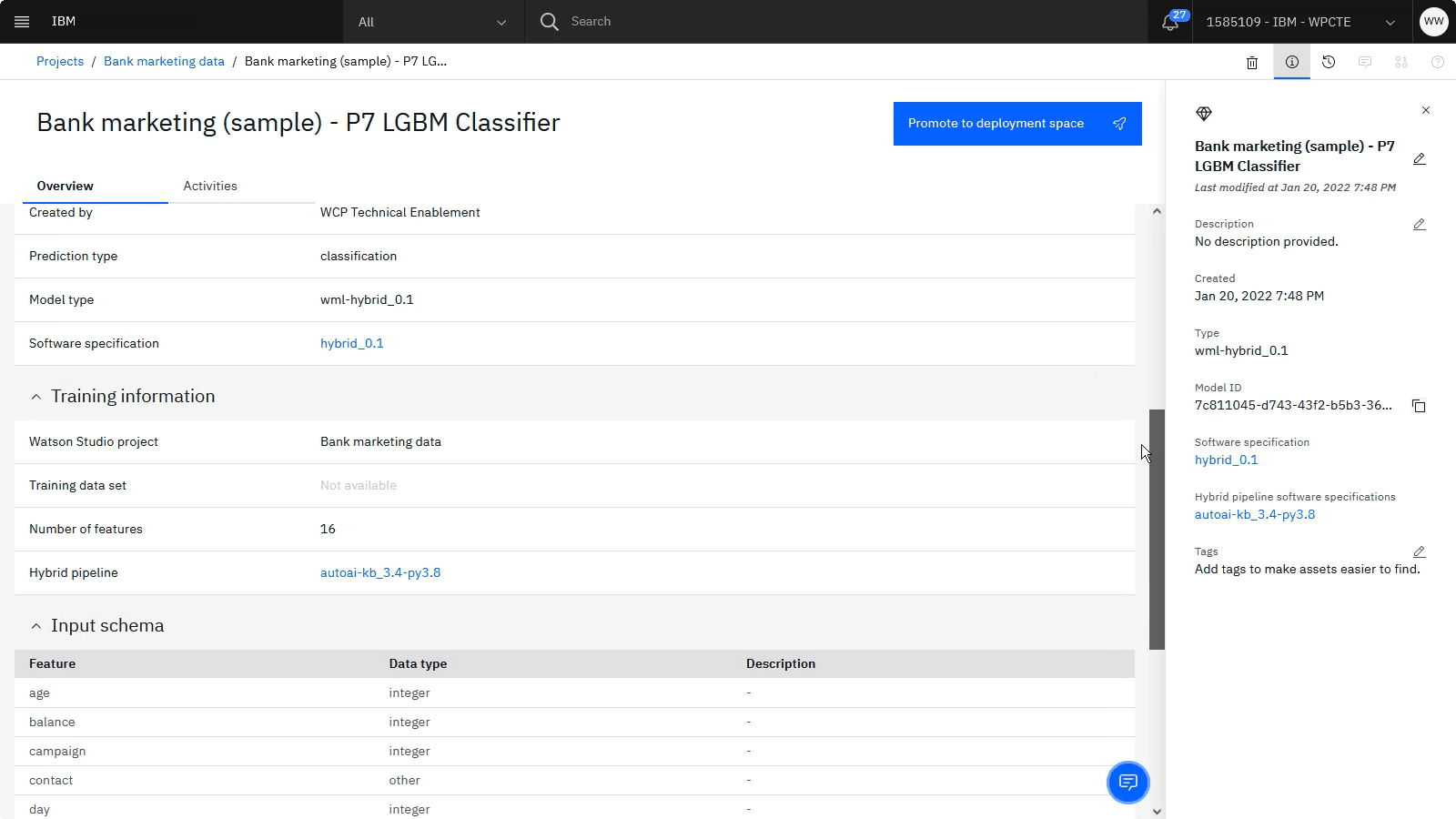

  12. Click Save as, select Model, and click Create. This saves the pipeline as a model in your project.
  13. When the model is saved, click the View in project link in the notification to view the model in your project. Alternatively, you can navigate to the Assets tab in the project, and click the model name in the Models section.
Checkpoint icon Check your progress
The following image shows the model.

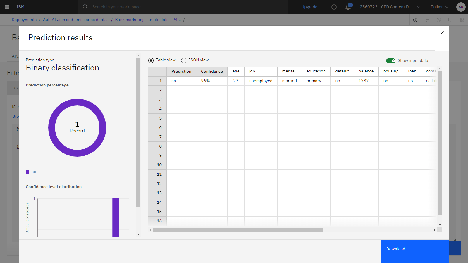

Task 4: Test the deployed model
Now that you have the model deployed, you can test that that online deployment using the user interface or through the Watson Machine Learning APIs. Follow these steps to use the user interface to test the model with new data:
  1. Click the Test tab. You can test the deployed model from the deployment details page in two ways: test with a form or test with JSON code.
  2. Click the JSON input tab, copy the following test data, and paste it to replace the existing JSON text:

  3. Click Predict to predict whether a customer with the specified attributes is likely to sign up for a particular kind of account. The resulting prediction indicates that this customer has a high probability of not enrolling in the marketing promotion.
  4. Click the X to close the Prediction results window.
The following image shows the results of testing the deployment. The values for your prediction might differ from the values in the following image.
