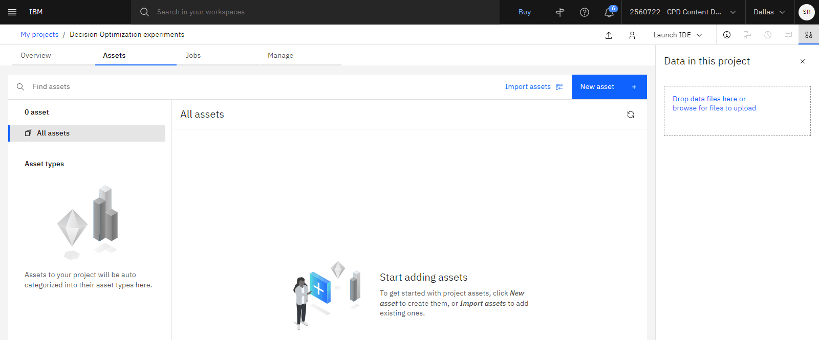

Task 1: Open a project
You need a project to store the data and the AutoAI experiment. You can use an existing project or create a project.
  1. From the Navigation Menu Navigation menu, choose Projects > All projects.
  2. Open an existing project. If you want to use a new project:
    1. Click New project.
    2. Select Create an empty project.
    3. Enter a name and optional description for the project.
    4. Click Create.
For more information, see Creating a project.
Checkpoint icon Check your progress
The following image shows the new project.

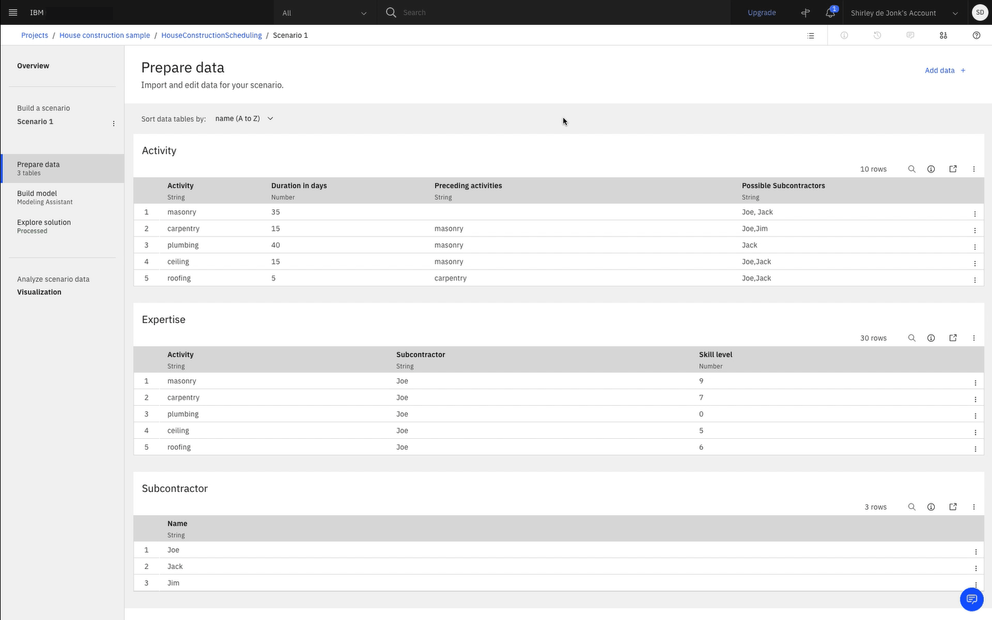

Task 3: Build a model and visualize a scenario result
Follow these steps to build a model and visualize the result using the Decision Optimization Modeling Assistant.
  1. In the left pane, click Build model to open the Modeling Assistant. This model was built with the Modeling Assistant so you can see that the objectives and constraints are in natural language, but you can also formulate your model in Python, OPL or import CPLEX and CPO models.
  2. Click Run to run the scenario to solve the model and wait for the run to complete.
  3. When the run completes, the Explore solution view displays. Under the Results tab, click Solution assets to see the resulting (best) values for the decision variables. These solution tables are displayed in alphabetical order by default.
  4. In the left pane, select Visualization.
  5. Under the Solutions tab, select Gantt to view the scenario with the optimal schedule.

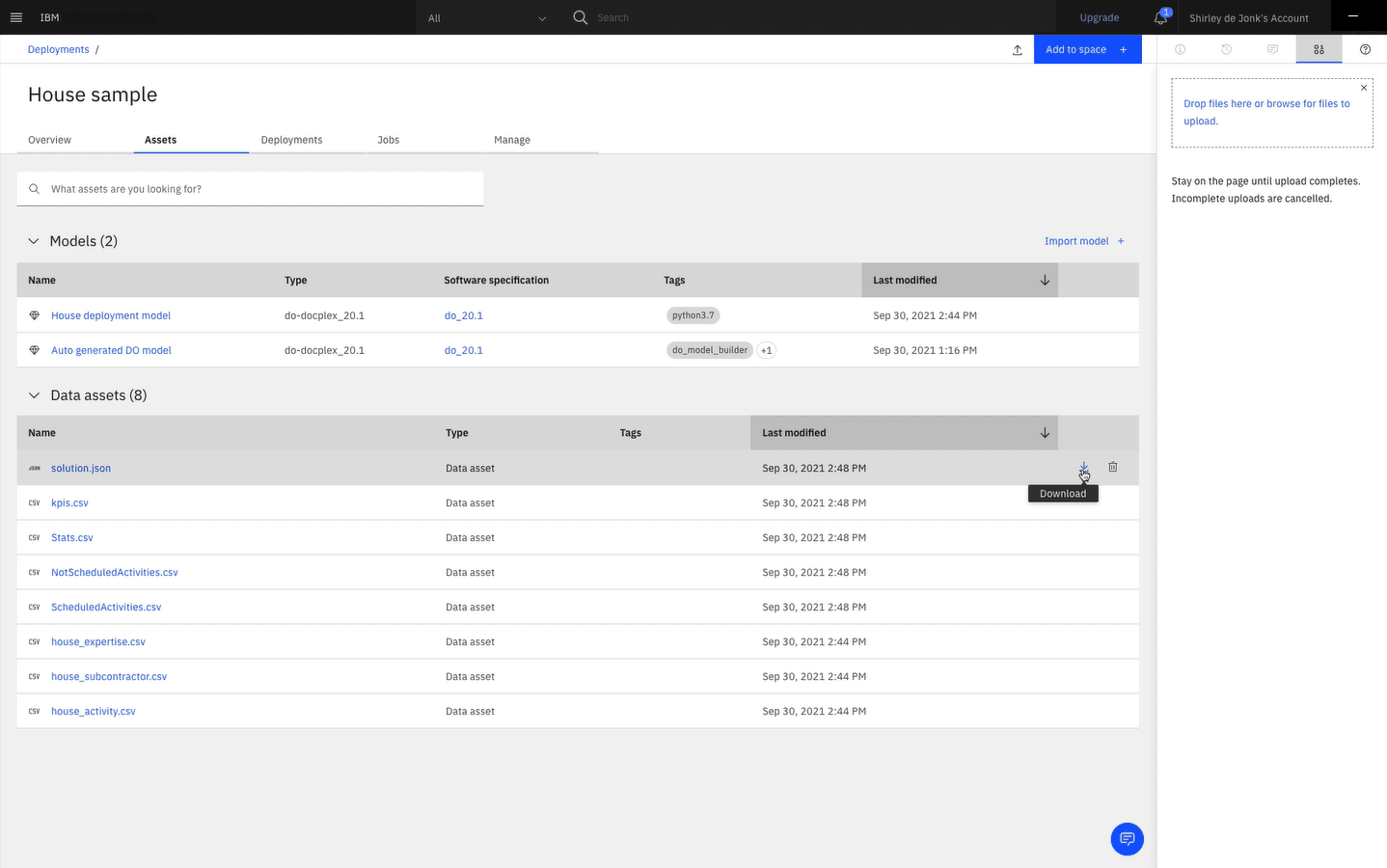

Task 6: Test a model
To test the model with a scenario, you must upload data files from your computer to the deployment space. Follow these steps to test the model by creating a job using the CSV files included with the sample zip file:
  1. Click House sample (or your deployment space) in the navigation trail to return to the deployment space.
  2. Click the Assets tab.
    1. In the HouseConstructionScheduling.zip file on your computer, you will find several CSV files in the .containers > Scenario 1 folder.
    2. Click the Upload asset icon Upload asset to project to open the Data panel.
    3. Drag the Subcontractor.csv, Activity.csv, and Expertise.csv files into the Drop files here or browse for files to upload area in the Data panel.
  3. Click the Deployments tab.
  4. Click House deployment.
  5. Now to submit a job to score the model, click New job.
  6. For the job name, type House construction job.
  7. Click Next.
  8. Select the default values on the Configure page, and click Next.
  9. Select the default values on the Schedule page, and click Next.
  10. Select the default values on the Notify page, and click Next.
  11. On the Choose data page, in the Input section, select the corresponding data assets that you previously loaded into your space for each input ID.
    1. For Input ID Subcontractor.csv, click Select data source > Subcontractor.csv > Confirm.
    2. For Input ID Activity.csv, click Select data source > Activity.csv > Confirm.
    3. For Input ID Expertise.csv, click Select data source > Expertise.csv > Confirm.
  12. In the Output section, you will provide the name for each solution table to be created.
    1. For Output ID ScheduledActivities.csv, click Select data source > Create new, type ScheduledActivities.csv for the name, and click Confirm.
    2. For Output ID NotScheduledActivities.csv, click Select data source > Create new, type NotScheduledActivities.csv for the name, and click Confirm.
    3. For Output ID stats.csv, click Select data source > Create new, type stats.csv for the name, and click Confirm.
    4. For Output ID kpis.csv, click Select data source > Create new, type kpis.csv for the name, and click Confirm.
    5. For Output ID solution.json, click Select data source > Create new, type solution.json for the name, and click Confirm.
    6. For Output ID log.txt, click Select data source > Create new, type log.txt for the name, and click Confirm.
  13. Review the information on the Choose data page, and then click Next.
  14. Review the information on the Review and create page, and then click Create and run.
  15. From the House deployment model page, click the job that you created named House construction job to see its status.
  16. After the job run completes, click House sample (or your deployment space) to return to the deployment space.
  17. On the Assets tab, you will see the output files:
    • ScheduledActivities.csv
    • NotScheduledactivities.csv
    • stats.csv
    • kpis.csv
    • solution.json
    • log.txt
  18. For each of these assets, click the Download icon, and then view each of these files.
