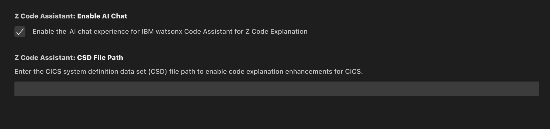

Install the WCA extension in VS Code to use the Chat experience for Code Explanation. To enable the chat experience, you need to opt in using the Z Code Assistant: Enable AI Chat setting in the IBM watsonx Code Assistant for Z VS Code extension.
The chat experience uses an agentic framework on the back end to interpret natural language requests and formulates a plan to answer them. For more information about the collection of API agents used in the code explanation, see Overview.
Figure 2. Code Explanation overview
Enable AI chat experience option in VS Code extension
