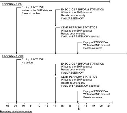

The following figure summarizes the statistics reset functions.
Figure 1. Summary of statistics reset functions
Counters can be reset by any of the following events: When the INTERVAL expires, if the statistics recording status is set to ON, statistics are written to the SMF data set, and the counters are reset. When you issue a PERFORM STATISTICS command, statistics are written to the SMF data set, and counters are only reset if ALL and RESETNOW are specified. When ENDOFDAY expires, statistics are written to the SMF data set, and the counters are reset.
