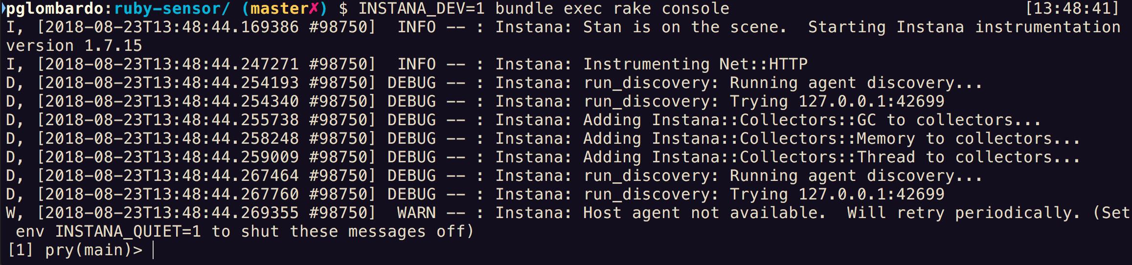

By default, the gem logs only messages that indicate whether any problems are encountered. If you want a more verbose logging output, set the INSTANA_DEBUG environment variable. It enables Debug-level logging in the Instana gem.
The following image displays the Instana console output:
In the preceding example, you can see that the host agent isn't available (either because it isn't running or wasn't installed). After the host agent is available, the Instana gem will automatically reconnect without any intervention.

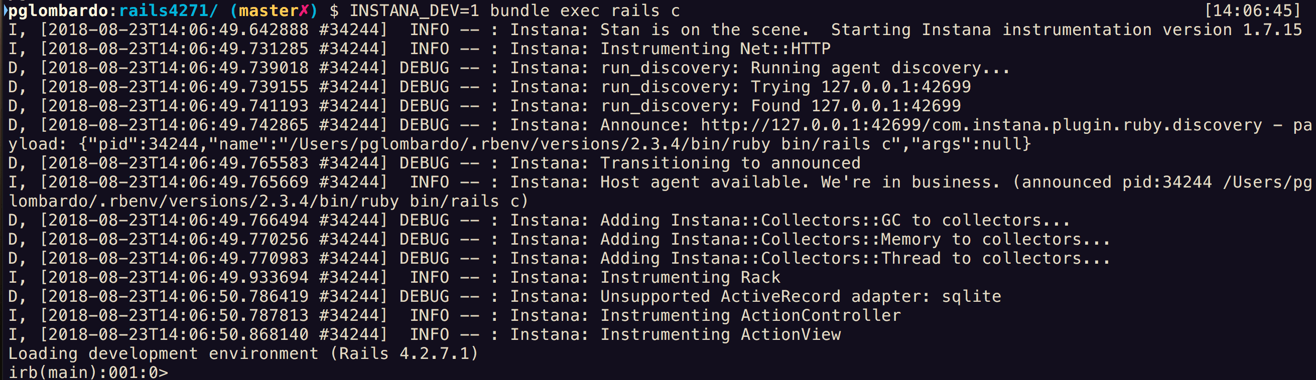

To diagnose the Instana gem from your application, often opening an application console with verbose logging can be enough to identify issues.
The following image displays the Rails console output:
In the preceding example, you can see the Instana Ruby gem initialize, instrument some components and a success notification: Host agent available. We're in business.
