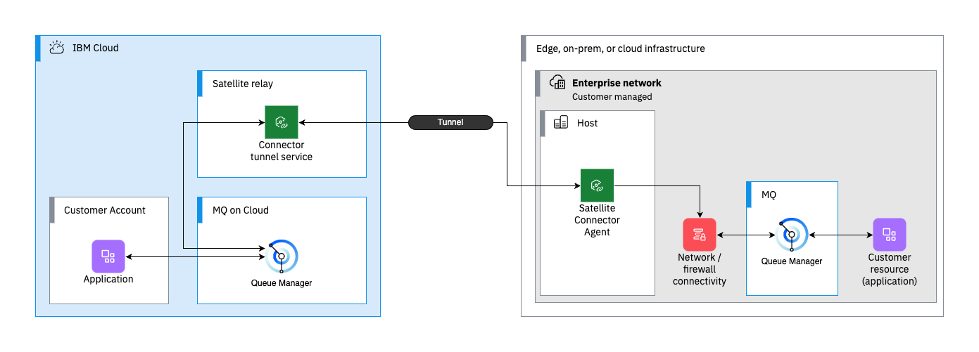

Connecting to an on-premises queue manager by using IBM Cloud Satellite Connector
IBM Cloud® Satellite Connector provides an endpoint for establishing a secure connection between IBM Cloud services and on-premises applications.
IBM® MQ as a Service queue managers that are deployed to an IBM Cloud deployment location can use Satellite Connectors to connect to secure on-premises applications.
Shows a depiction of a satellite connector
The Satellite Connector endpoint is only contactable within the IBM Cloud private endpoint network, and is only reachable from within IBM Cloud. When connecting an IBM MQ queue manager on cloud to an on-premises queue manager using the IBM Cloud Satellite Connector, channels must be started from the IBM Cloud queue manager to account for this. The Satellite Connector agent in the on-premises network routes the connection to the correct endpoint for the on-premises queue manager.
To achieve this the following channel definitions can be used:
  • Requester (cloud) - Server (on-premises)
    • This pattern enables message flow from on-premises to the cloud.
    • The Requester channel is given the hostname and port of the Satellite Connector as its connection details.
    • The Server channel is started by the Requester channel.
  • Sender (cloud) - Receiver (on-premises)
    • This pattern enables message flow from cloud to on-premises.
    • The Sender channel is given the hostname and port of the Satellite Connector as its connection details.
    • The Receiver channel is started by the Sender channel.

The following scenario has four main components; a cloud queue manager, an on-premises queue manager, a Satellite Connector Instance, and a Satellite Connector Agent.
  1. A cloud-hosted queue manager in an IBM MQ as a Service on Cloud service instance.
  2. An IBM MQ queue manager set up in your on-premises environment.
    • In the following steps, the name of the on-premises queue manager is referred to as ONPREM.
    • Follow these instructions to set up an IBM MQ queue manager in a container with TLS configured.
  3. Create a Satellite Connector in your IBM Cloud account
  4. Set up a Satellite Connector Agent in your on-premises environment
  5. Set up a user endpoint in your Satellite Connector instance
