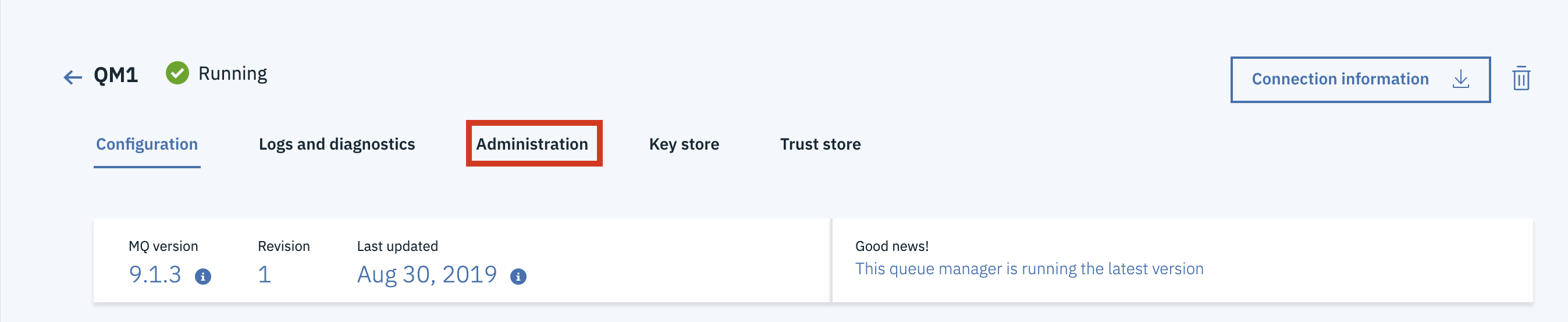

  3. Next, select the Administration tab:
    Shows the configuration tab

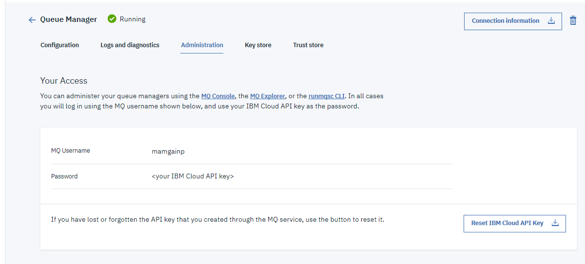

    If the button says Create API Key, then you have not created an api key in this way before. Click the Create API Key button.
  5. Click Download to download platformApiKey.json file containing an admin username and apikey.
    Shows the API key successfully created message
