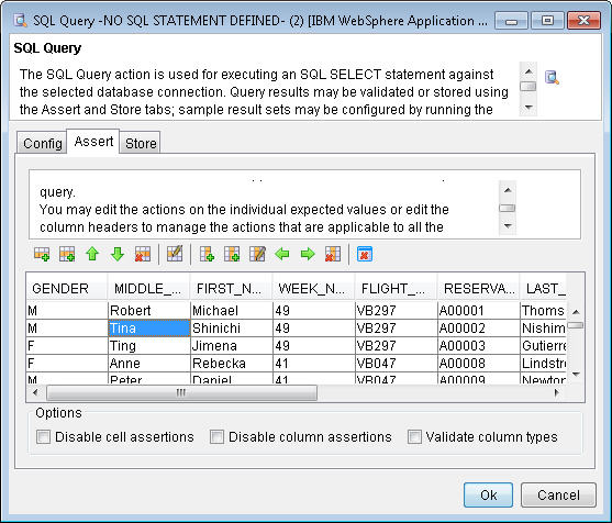

If you did not run a test query and save the results, you can add data from the Assert tab or Store tab, by using the icons.
If you ran a test query and saved the results, the column headings (and data) are displayed in the Assert tab and Store tab, and the rows, columns, and cells can be edited and arranged by using these same icons above the data. To see what an icon does, hover over it.

To change the validation rules for a cell or column, use the Assert tab. Column assertion validates that all cells in a column match the rule for that column. For example, you might want to assert that all cell values for that column match a certain regular expression. Cell assertion validates that a specific cell for that column matches the rule set for that cell. You can use both cell and column validation rules. For example, you might want to assert that all values in the column contain 4 digits and that a specific cell contains the value 1234.
Procedure
  1. Customize the validation options by using options that are described in the following table. If assertions are disabled, assertions can still be created and modified, but they are not used, including the comparison between the number of rows that are expected and the number received.
    Important: Cells with no enabled Assert actions are shown in gray. Cells with enabled assert actions are turned on by default. When you edit a cell, by default the validation is an Action Type of Equality and it is turned on. However, when you edit a column, the default validation, Action Type of Equality is turned off. If you want to use the default column validation or change that validation to another action type, you must turn it on.
    Option Definition
    Disable cell assertions To disable cell assertions, click the Disable cell assertions check box. This selection disables any assertion actions that exist in the cells. When this option is selected, column assertions are used.
    Disable column assertions To disable column assertions, click the Disable column assertions check box. This selection disables any assertions that are made on any received value, independent of the cell assertions. When this option is selected, cell assertions are used.
    Validate column types To validate column types, click the Validate column types check box. This selection validates any data types that are made on any received value, independent of the cell types. When this option is selected, column data types are validated.
  2. Customize the validation options further by enabling or disabling cell assertions on a column by column basis. Some examples are shown.
    Validate actions are disabled for all cells in GENDER and WEEK_NUMBER and enabled for all cells in the other columns.
    Disable cells per columns
    By selecting the Field Actions menu on a column, you can see that all cells in that column have an enabled Equality action.
    Field actions menu for a column
    When you click Field Actions > Validate > Equality the validation of all cells in the column are disabled.
    If some cells in a column are enabled with the Equality action and other cells are disabled, you see Field Actions > Validate > ? Equality when you select the Field Actions menu.
    Field actions menu with some cells enabled and some cells not enabled
    If some cells in a column are enabled with the different Assert actions, you can see those actions when you select the Field Actions menu.
    Field Actions menu with different cell Assert actions.
