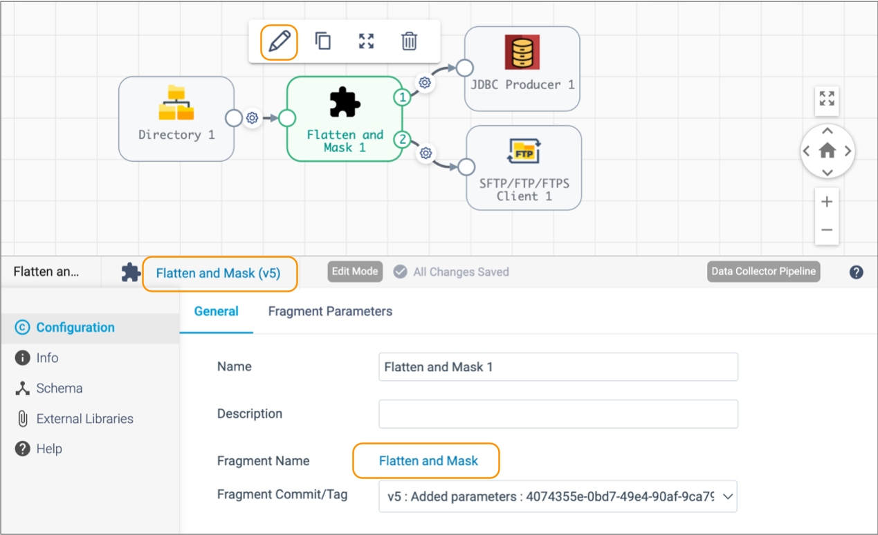

You cannot edit a fragment when designing a pipeline. To navigate away from the pipeline to edit the fragment, select the fragment in the canvas and then click the Edit Fragment icon (Edit Fragment icon) or click the fragment name in the properties panel:
Links to edit a fragment when designing a pipeline

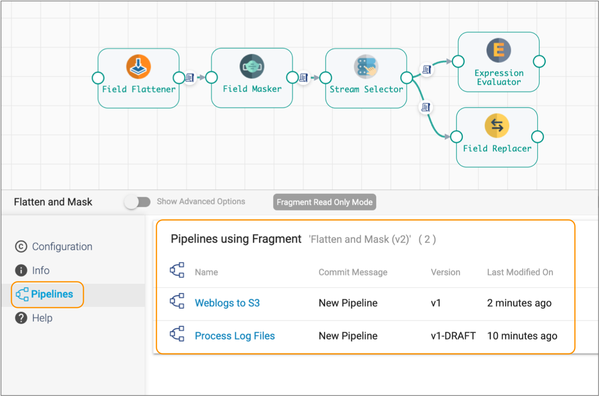

You can see the pipelines that use a fragment version on the Pipelines tab of the fragment details pane, as shown in the following image:
Pipelines tab displaying the pipelines that use a fragment version
You can click a pipeline name to quickly navigate to the pipeline.

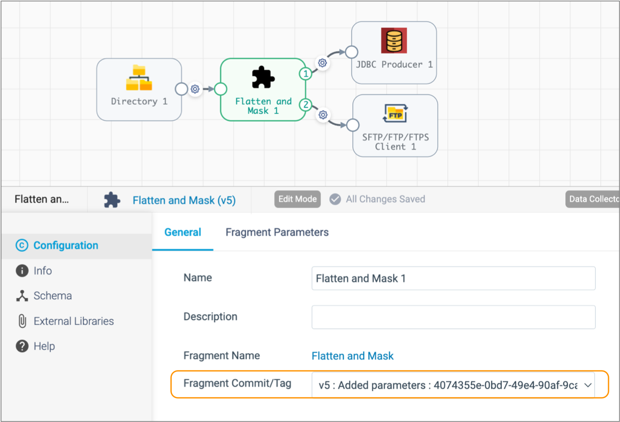

To view or change the fragment version used in a pipeline, select the fragment, then configure the Fragment Commit/Tag property as needed:
Change the fragment version with the Fragment Commit/Tag property

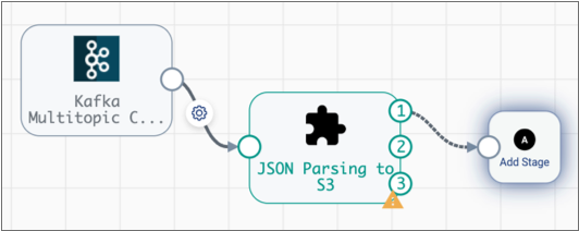

For example, the following fragment stage has three output streams:
Fragment stage with three output streams

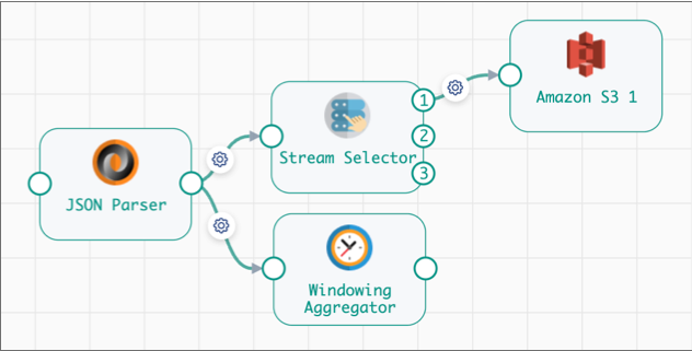

The expanded fragment looks like this:
Expanded fragment
The stream order follows the primary branch, JSON Parser to Amazon S3, then returns to the remaining Windowing Aggregator branch. So the resulting stream order for this fragment is as follows:
