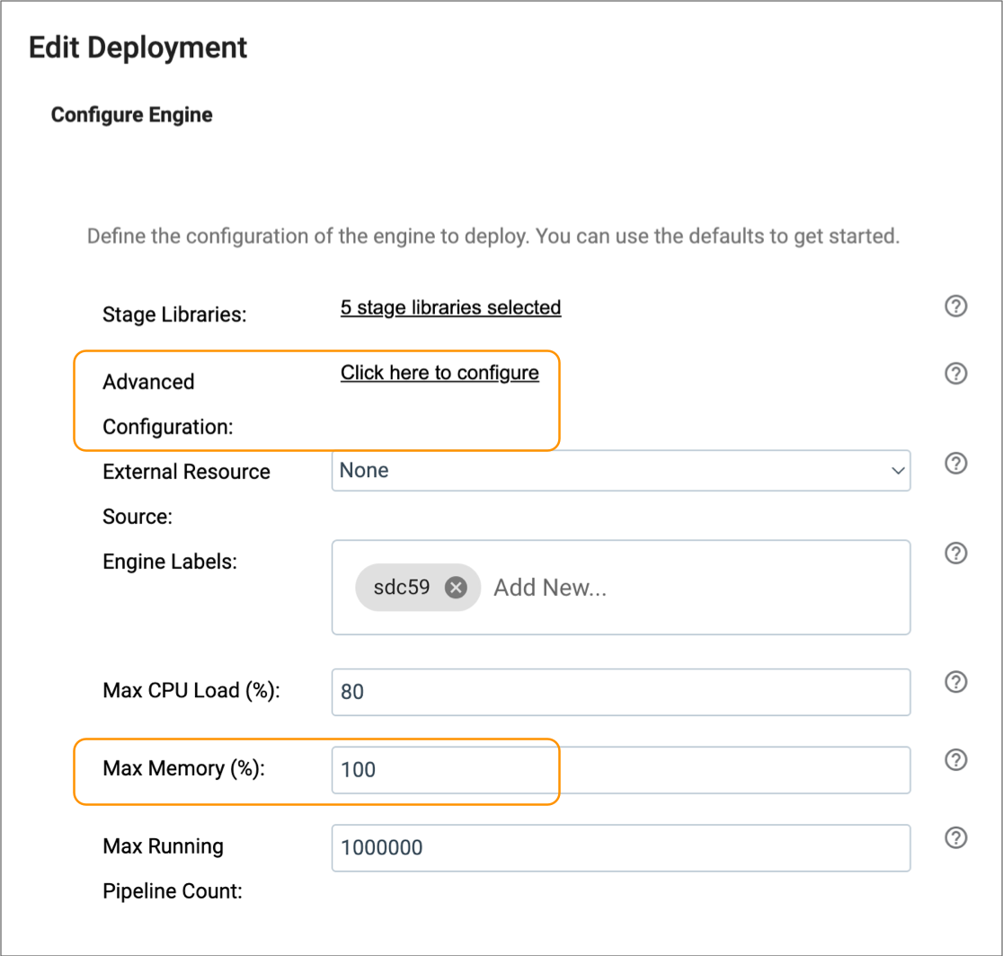

You configure both the Java heap size and the memory resource threshold in the following locations in the Configure Engine step when you configure the deployment:
Java heap size and memory resource threshold locations in the Configure Engine step for a deployment
To configure the Java heap size, click Click here to configure next to Advanced Configuration. Then, click Java Configuration. You can configure a percentage of available memory on the host machine or an absolute number as the Java heap size, as described in the following engine documentation:
To configure the maximum memory threshold, define a percentage in the Max Memory (%) property.

  4. By default, the Java heap size for the engine is set to 50% of the available memory. In most cases, the default percentage value is sufficient. You can optionally modify the heap size as needed.
    1. Click Click here to configure next to Advanced Configuration.
    2. Click Java Configuration.
    3. Select the JVM memory strategy to use, and then configure the minimum and maximum Java heap size.

  5. Modify the following threshold values:
    Threshold Description
    Max CPU Load (%)
    Maximum percentage of CPU on the host machine that an engine instance can use. When an engine equals or exceeds this threshold, Control Hub does not start new pipeline instances on the engine.
    Default is 80.
    Max Memory (%)
    Maximum percentage of the configured Java heap size that an engine instance can use. When an engine equals or exceeds this threshold, Control Hub does not start new pipeline instances on the engine.
    Default is 100.
    Max Running Pipeline Count
    Maximum number of pipelines that can be running on each engine instance. When an engine equals this threshold, Control Hub does not start new pipeline instances on the engine.
    Default is 1,000,000.
