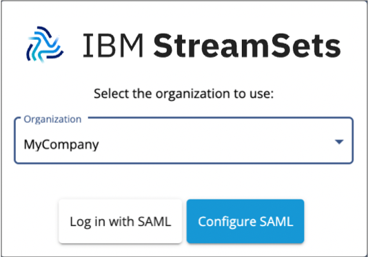

Logging in when SAML is incorrectly configured
If SAML authentication is enabled but the IdP or the SAML configuration in Control Hub is incorrectly configured, no organization users can log in to IBM StreamSets using SAML authentication. In this case, a user with the Organization Administrator role can log in using local or public identity provider authentication to access the Control Hub organization SAML configuration page only.
  1. Enter the following URL in the address bar of your browser:
    https://cloud.login.streamsets.com
  2. Log in as a user with the Organization Administrator role using one of the following authentication methods:
    • Local - Enter your email address and password.
    • SSO with a public identity provider - Continue with a public identity provider account, such as Google or Microsoft.
  3. Select the organization to use, and then click Configure SAML.
    Logging in to access the organization SAML configuration page
    The organization SAML configuration page displays.
  4. Use the following tabs to resolve the issues:
    • Production tab - You can temporarily disable SAML authentication so that users can log in using local or public identity provider authentication until you can resolve the SAML issues.
    • Draft tab - Edit, test, and publish an updated SAML configuration.
