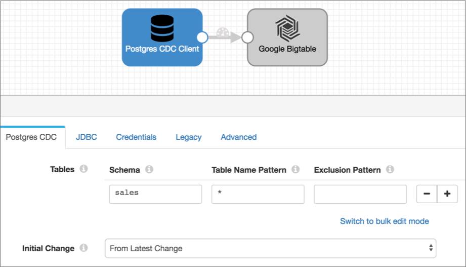

Example
You want to process all existing data in the Sales schema and then capture changed data, writing all data to Google Bigtable. To do this, you create two pipelines.
To read the existing data from the schema, you use a pipeline with the JDBC Multitable Consumer and Google Bigtable destination as follows:
Once all existing data is read, you stop the JDBC Multitable Consumer pipeline and start the following PostgreSQL CDC Client pipeline. This pipeline is configured to pick up changes that occur after you start the pipeline, but if you wanted to prevent any chance of data loss, you could configure the initial change for an exact datetime or earlier LSN:
