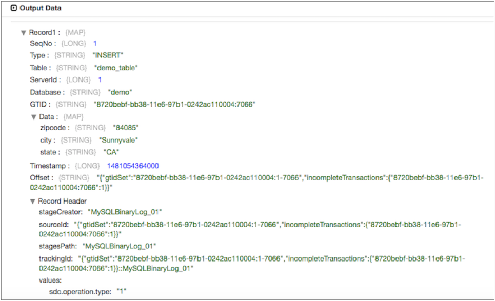

For example, the origin generates the following record when it reads a binary log file for a MySQL server with GTID enabled for a table without a primary key:
