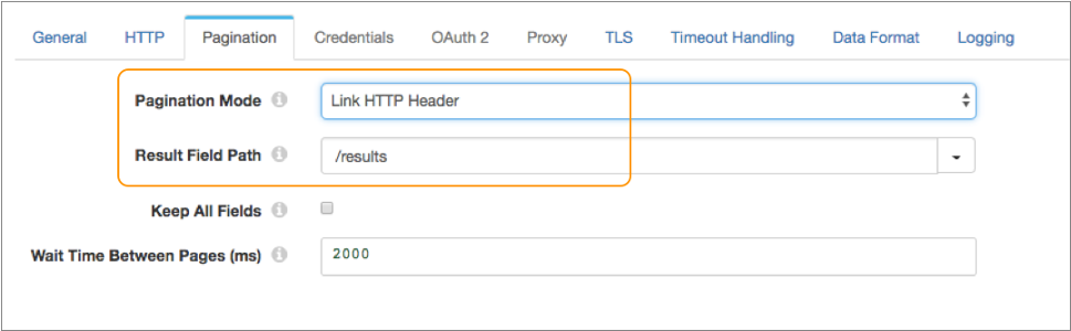

Example for Link in HTTP Header
link:<https://myapp.com/api/objects?page=2>; rel="next",
<https://myapp.com/api/objects?page=9>; rel="last"So after the HTTP Client origin reads the first page of results, it can use the next link in the HTTP header to read the next page.
https://myapp.com/api/objects?page=1{
"total":"2000",
"limit":"10",
"results":[
"firstName":"Joe",
"lastName":"Smith"
"firstName":"Joanne",
"lastName":"Smythe"
}On the Pagination tab of the
stage, you simply set Pagination Mode to link in HTTP header, and
then you set the result field path to the /results field:

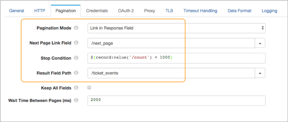

Example for Link in Response Field
The API of the HTTP client uses a field in the response body to access the next page. It requires that you include a timestamp in the resource URL indicating which items you want to start reading.
http://myapp.com/api/tickets.json?start_time=138301982{
"ticket_events":[
"ticket_id":27,
"timestamp":138561439,
"via":"Email"
"ticket_id":30,
"timestamp":138561445,
"via":"Phone"
"next_page":"http://myapp.com/api/tickets.json?start_time=1389078385",
"count":1000,
"end_time":1389078385
the stage, you set Pagination Mode to link in response field, and
set the next page link field to the /next_page field.
${record:value('/count') < 1000}Then you set the result field path to the
/ticket_events field:

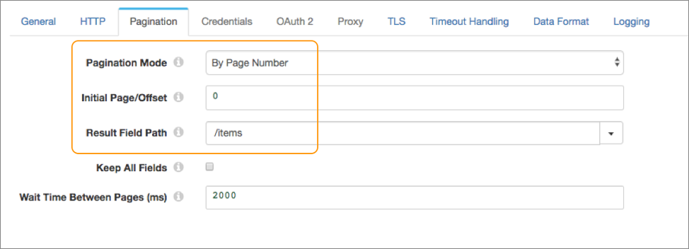

Example for Page Number
The API of the HTTP client uses page number pagination. It requires that you include a page parameter in the URL that specifies the page number to return from the results.
${startAt}
variable:https://myotherapp.com/api/v1/products?page=${startAt}{
"total":"2000",
"items":[
"item":"pencil",
"cost":"2.00"
"item":"eraser",
"cost":"1.10"
stage, you set Pagination Mode to by page number. You want to
begin processing from the first page in the results, so you set the initial page to 0.
Then you set the result field path to the /items field:

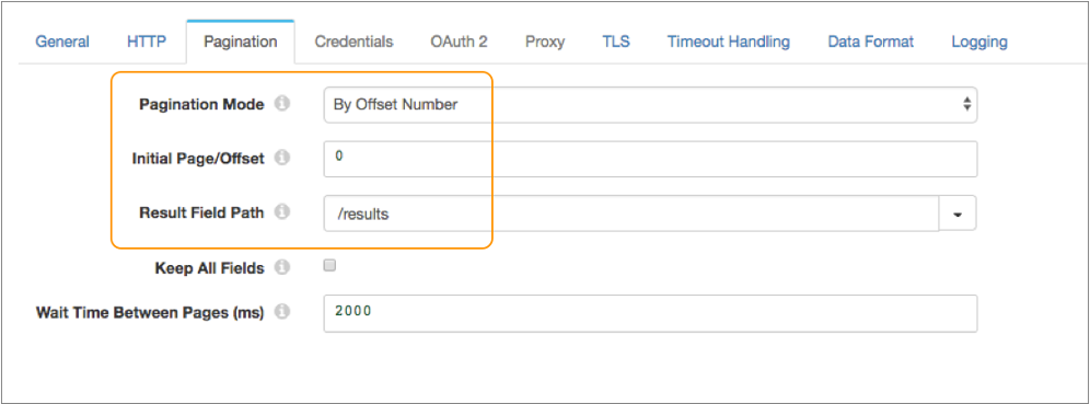

Example for Offset Number
limit- Specifies the number of results per page.offset- Specifies the offset value.
${startAt}
variable:https://myapp.com/product?limit=10&offset=${startAt}{
"total":"2000",
"limit":"10",
"results":[
"firstName":"Joe",
"lastName":"Smith"
"lastName":"Smythe"
stage, you set Pagination Mode to by offset number. You want to
begin processing from the first item in the results, so you set the initial offset to 0.
Then you set the result field path to the /results field:

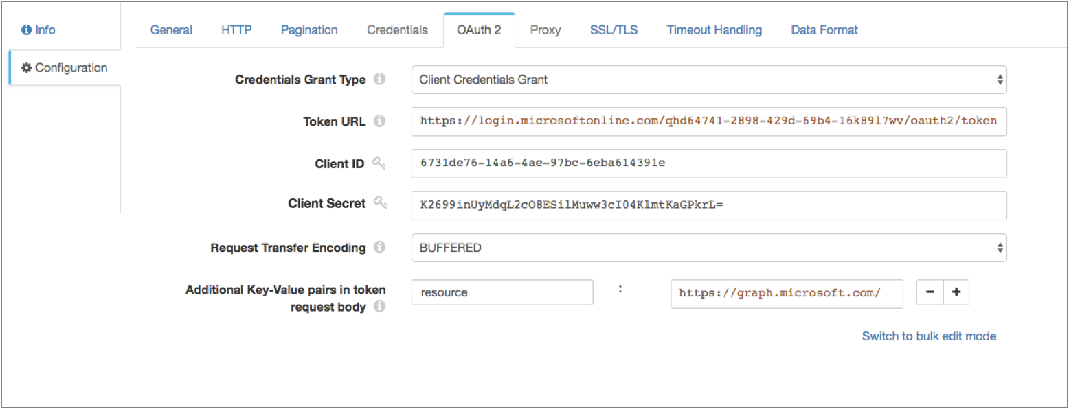

Example for Microsoft Azure AD
To use OAuth 2 authorization to read from Microsoft Azure AD, configure HTTP Client to use no authentication and the client credentials grant.
The following image shows the OAuth 2 tab configured for Microsoft Azure AD version 1.0:

Before you configure the stage, create a service account and delegate domain-wide authority to the service account. For details, see the Google Identity documentation: Using OAuth 2.0 for Server to Server Applications.
For more information about Google service accounts, see the Google Cloud documentation: Understanding service accounts.
For more information about configuring OAuth 2 authorization for Google, see the Google Identity documentation: Using OAuth 2.0 to Access Google APIs.
