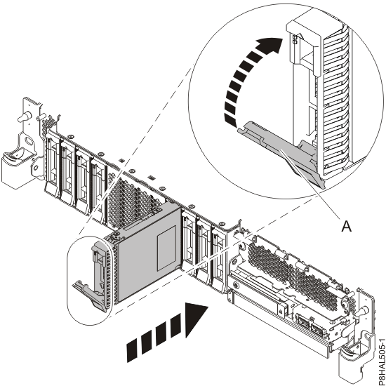

- Unlock the drive bay handle (A) by pressing it and pulling it out toward you. If the handle is not all the way out, the drive does not slide into the system. See Figure 2 and Figure 3.
- Hold the drive by the top and bottom edges as you position the drive, and insert it into the drive slot.
- Slide the drive halfway into the system.
- Return to the console, and then press Enter. In the Verify Device Concurrent Add display, verify that the selected slot is the slot in which you want to install the drive.
- When the identify LED flashes for the selected slot, slide the
drive all the way into the slot, and push the drive bay handle (A) in until
it locks, as shown in Figure 2 and Figure 3.Important: Ensure that the drive is fully seated and is all the way into the system.Figure 2. Replacing a disk drive in a base function system
Figure 3. Replacing a disk drive in an expanded function system

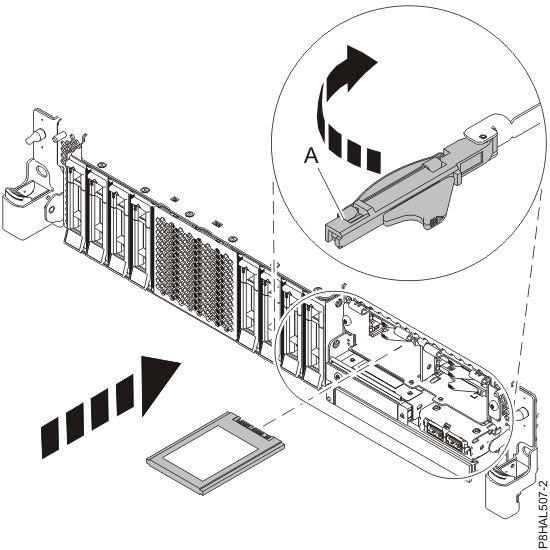

- With the SSD drive bay handle (A)
in the unlocked position, pull the lever outward to gain access to the guide rails in the SSD slot.
Support the bottom of the SSD as you align it with the guide rails in the SSD slot. See Figure 5.Note: Support the drive by holding the drive by its sides.
- On the console, press Enter on the Complete Device Concurrent Add display to indicate that the drive is installed. The service indicator stops flashing and turns off for that drive slot.
- When the identify LED flashes for the selected slot, slide the drive all the way into the slot until the drive stops.
- Lock the drive by rotating the bay handle (A) in
the direction that is shown in Figure 5.Important: When you install an SSD, ensure that the SSD is fully seated and is all the way into the system.Figure 5. Replacing an SSD in an expanded function system
