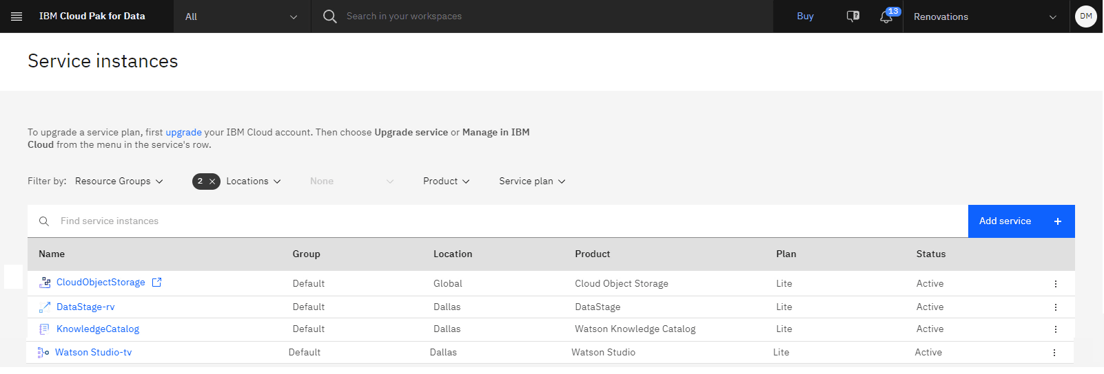

Checkpoint icon Check your progress
The following image shows the provisioned services.

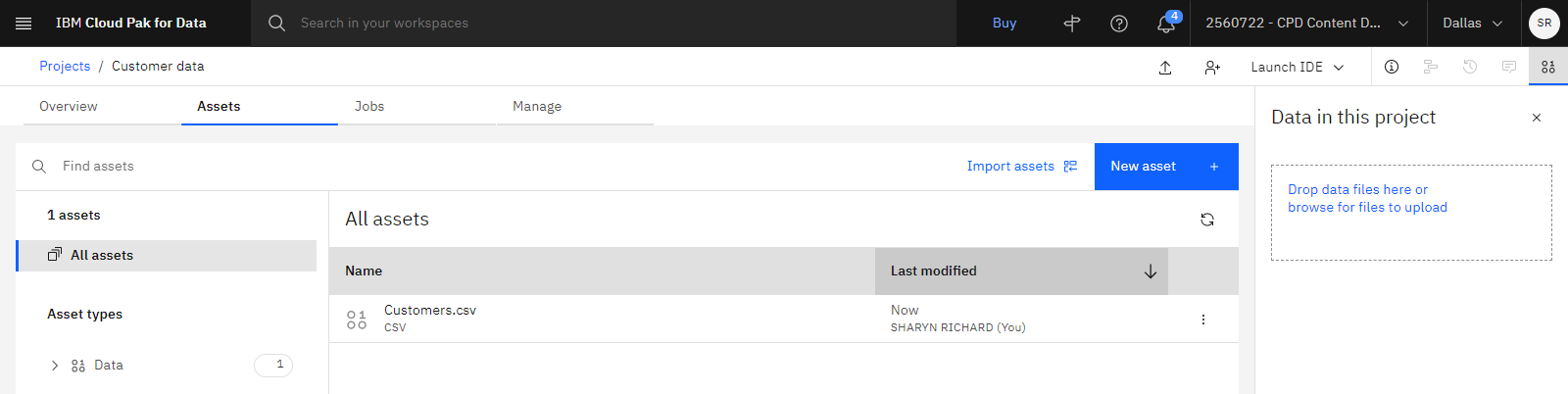

The following image shows the Assets tab in the project.

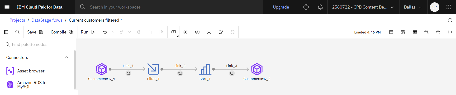

The DataStage flow will contain four nodes: the original data asset, a filter node, a sort node, and the transformed data asset. Follow these steps to create the DataStage flow:
  1. Click New asset > Transform and integrate data.
  2. Provide a name and description, and then click Create.
  3. Click Connectors then drag and drop the Asset browser node onto the canvas.
  4. Select Data Asset > customers.csv, and click Add.
  5. In the Node palette, expand the Stages section, and then drag the Filter node to the canvas.
  6. To link the nodes together, click the blue arrow on the Customers.csv node and drag it to the Filter node.
  7. On the Stages section, drag the Sort node to the canvas.
  8. Connect the Filter node to the Sort node.
  9. Expand the Connectors section, and then drag the Asset browser node on the canvas.
  10. Select Data Asset > customers.csv, and click Add. You will change the file name later so you do not overwrite the customer.csv file.
  11. Connect the Sort node to this last Customers.csv node.

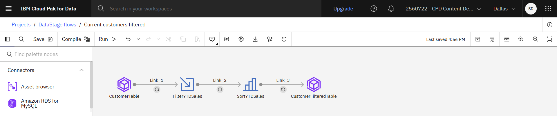

The following image shows the initial flow.
The following image shows the final flow.
