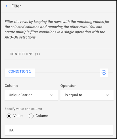

    01:24 Say, you want to focus on delays just for a specific airline, so you can filter the data to show only those rows where the unique carrier is United Airlines.

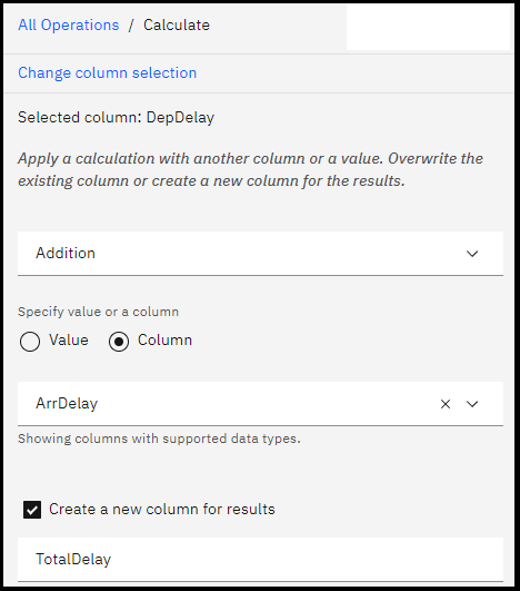

    01:42 It would be helpful to see the total delay.
    01:45 You can do that by creating a new column to combine the arrival and departure delays.
    01:50 Notice that the column type is inferred to be integer.
    01:54 Select the departure delay column, and use the "Calculate" operation.
    02:03 In this case, you'll add the arrival delay column to the selected column and create a new column called "TotalDelay".
    02:13 You can position the new column at the end of the list of columns or next to the original column.
    02:21 When you apply the operation, the new column displays next to the departure delay column.

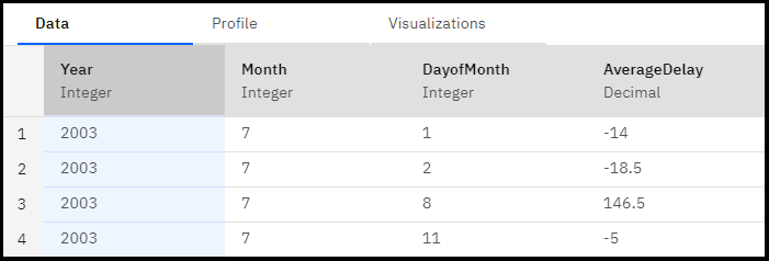

    02:44 Next you'd like to focus on the "TotalDelay" column, so you can use the "select" operation to move the column to the beginning.
    03:02 This command arranges the total delay column as the first in the list, and everything else comes after that.

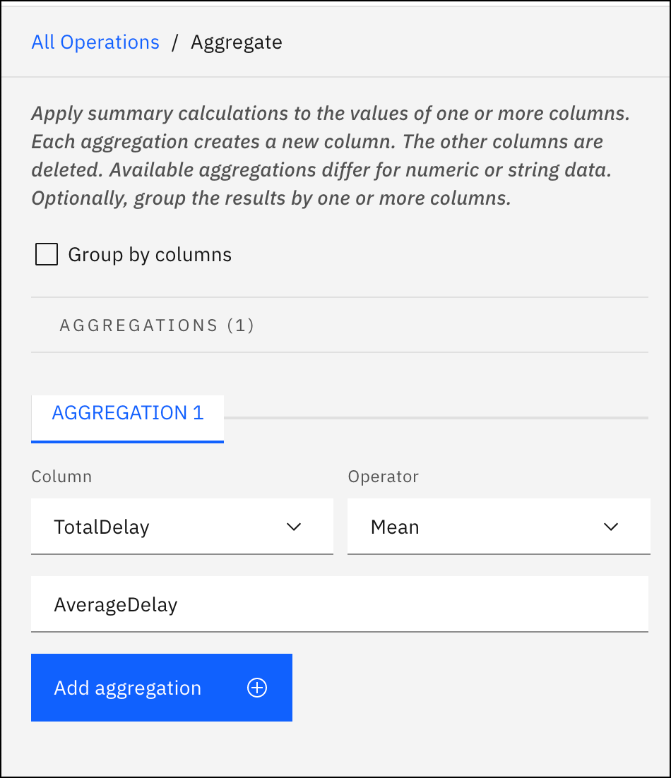

    03:12 Lastly, you want to find the mean of the "TotalDelay" column.
    03:16 When you expand the operations menu in the "Organize" section you'll find the "Aggregate" operation, which includes the "Mean" function.
    03:33 Now, you have a new column called "AverageDelay" that represents the average for the total delay.

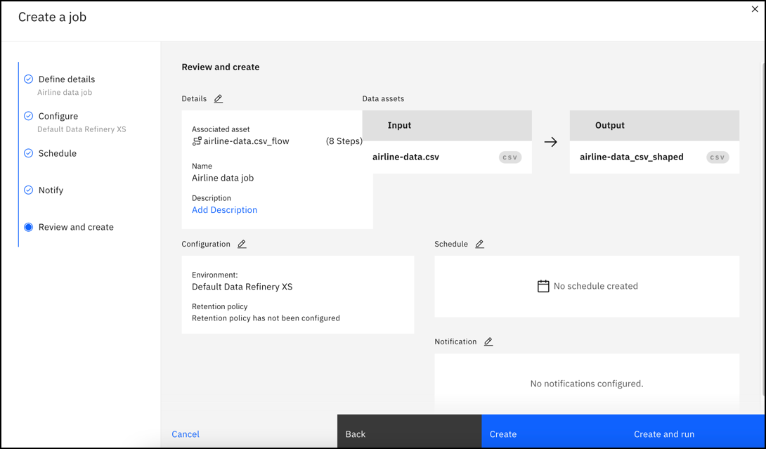

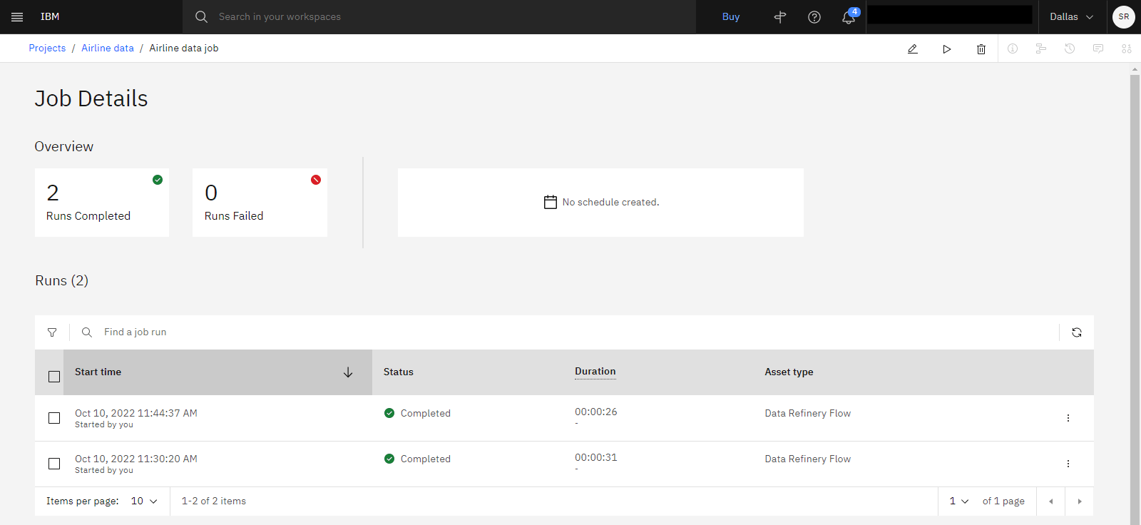

    03:40 Now to run the data flow, save and create the job.
    03:47 Provide the name for the job and continue to the next screen.
    03:52 The "Configure" step allows you review what the input and output of your job run will be and select the environment used to run the job.
    04:03 Scheduling a job is optional, but you can set a date and repeat the job if you'd like.
    04:13 And you can choose to receive notifications for this job.
    04:19 Everything looks good, so create and run the job.
    04:22 This could take several minutes, because, remember, that the data flow will be run on the full dataset.
    04:28 In the meantime, you can view the status.

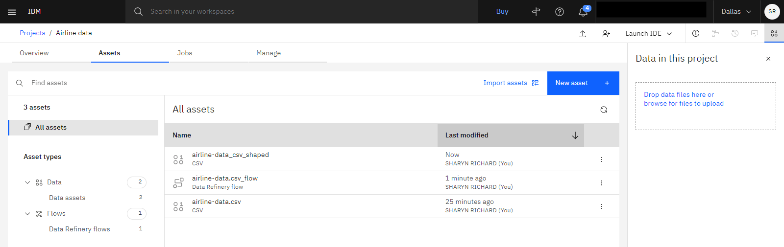

    04:34 When the run is complete, you can go back to the "Assets" tab in the project and open the Data Refinery flow to further refine the data.
    04:50 For example, you could sort the "AverageDelay" column in descending order.

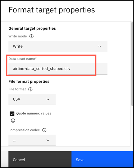

    05:18 And on the "Target data set" panel, you can specify an alternate location, such as an external data source.
    05:28 You can also edit the properties for the target, such as the write mode, the file format, and change the dataset asset name.
    05:43 Now, run the data flow again; but this time save and view the jobs.
    05:51 Select the job that you want to view from the list and run the job.
    06:03 When the run completes, go back to the project.

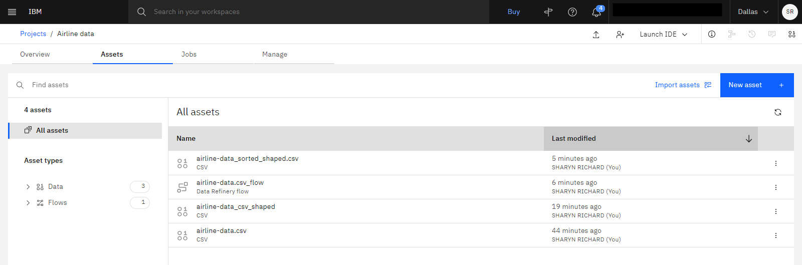

    06:08 And on the "Assets" tab, you'll see all three files: the original; the first refined dataset, showing the "AverageDelay" unsorted; and the second dataset, showing the "AverageDelay" column sorted in descending order.
    06:34 And back on the "Assets" tab, there's the Data Refinery flow.

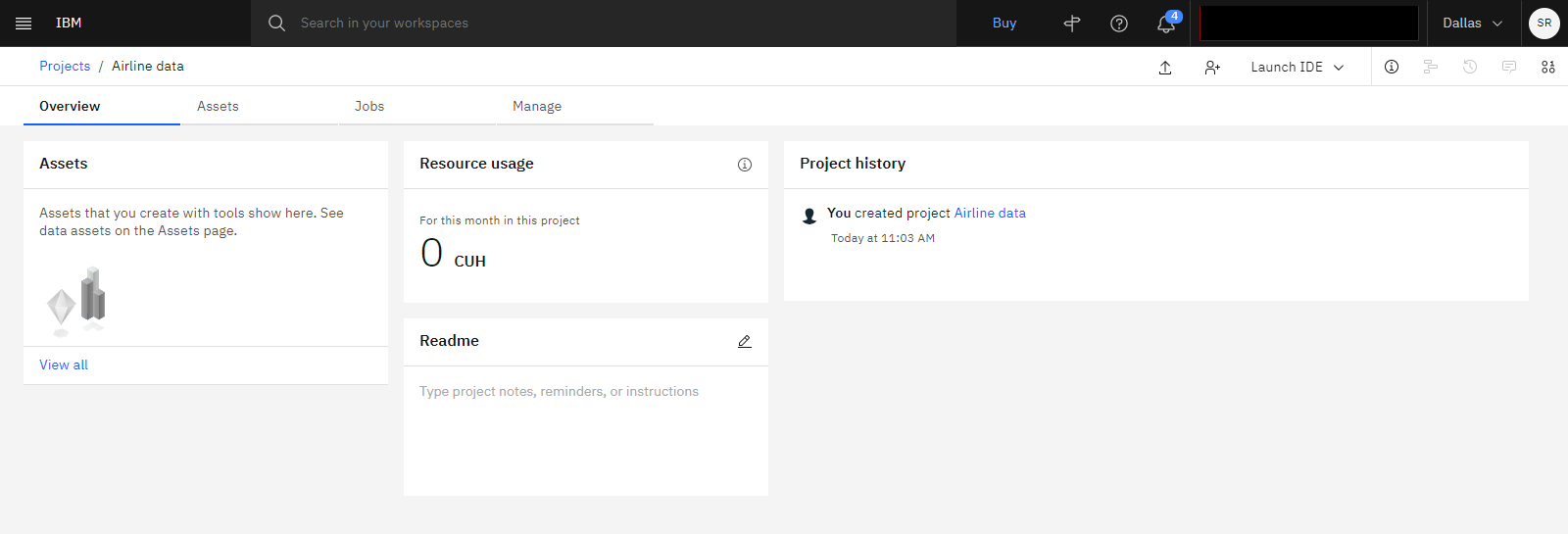

Task 1: Open a project
You need a project to store the data and the Data Refinery flow. You can use an existing project or create a project.
  1. From the Navigation Menu Navigation menu, choose Projects > View all projects.
  2. Open an existing project. If you want to use a new project:
    1. Click New project.
    2. Select Create an empty project.
    3. Enter a name and optional description for the project.
    4. Choose an existing object storage service instance or create a new one.
    5. Click Create.
Checkpoint icon Check your progress
The following image shows a new, empty project.

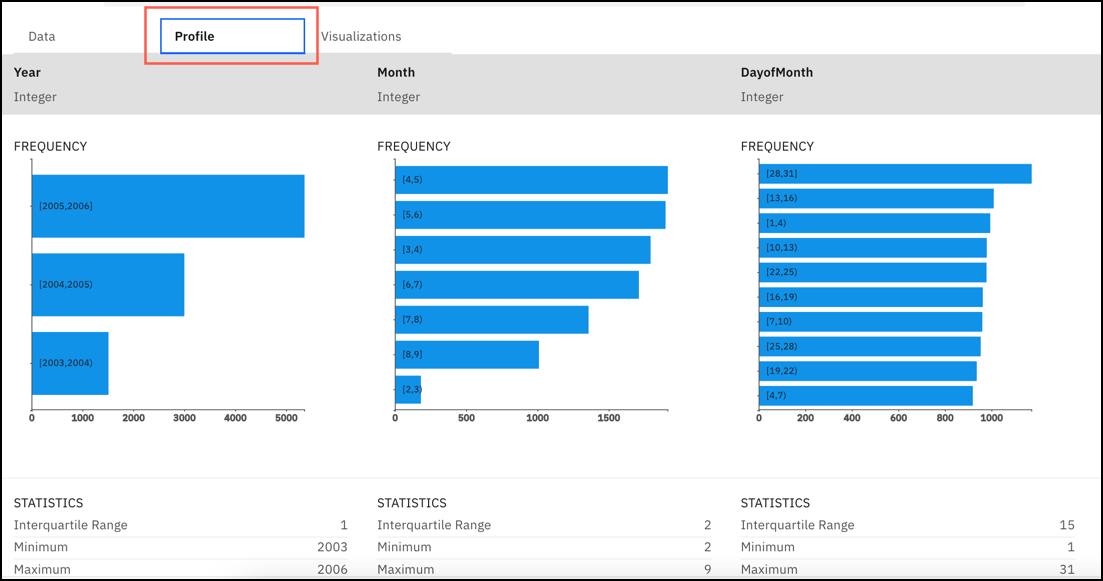

  1. Click the Profile tab to review the frequency distribution of the data so that you can find the outliers.
    1. Scroll through the columns to the see the statistics for each column. The statistics show the interquartile range, minimum, maximum, median and standard deviation in each column.
    2. Hover over a bar to see additional details.
    The following image shows the Profile tab:
    Profile tab

  4. Focus on the delays for a specific airline. This tutorial uses United Airlines (UA), but you can choose any airline.
    1. Click New step, and then choose the GUI operation Filter.
    2. Choose the UniqueCarrier column.
    3. For Operator, choose Is equal to.
    4. For Value, type the string for the airline for which you want to see delay information. For example, UA.
      Filter operation
    5. Click Apply. Scroll to the UniqueCarrier column to see the results.
  5. Create a new column that adds the arrival and departure delay times together.
    1. Select the DepDelay column.
    2. Notice that the Convert column type operation was automatically applied as the first step to convert the String data types in all the columns whose values are numbers to Integer data types.
    3. Click New step, and then choose the GUI operation Calculate.
    4. For Operator, choose Addition.
    5. Select Column, and then choose the ArrDelay column.
    6. Select Create new column for results.
    7. For New column name, type TotalDelay.
      Calculate operation
    8. You can position the new column at the end of the list of columns or next to the original column. In this case, select Next to original column.
    9. Click Apply. The new column, TotalDelay, is added.

    5. Use the select coding operation for the TotalDelay column. In the command-line text box, select the select operation.
      Click <column>, and choose the TotalDelay column. The command should look like this:
      select(`TotalDelay`)
    6. Click Apply. The shaped data now consists of the Year, Month, DayofMonth, and TotalDelay columns.
      The following screen image shows the first four rows of the data.
      The first four rows of the Data Refinery flow with the Year, Month, DayofMonth, and TotalDelay columns
  8. Show the mean of the values of the TotalDelay column, and create a new AverageDelay column:
    1. Click New step, and then choose the GUI operation Aggregate.
    2. For the Column, select TotalDelay.
    3. For Operator, select Mean.
    4. For Name of the aggregated column, type AverageDelay.
      Aggregate operation
    5. Click Apply.
      The new column AverageDelay is the average of all the delay times.
The following image shows the first four rows of the data.

When you run a job for the Data Refinery flow, the steps are run on the entire data set. You select the runtime and add a one-time or repeating schedule. The output of the Data Refinery flow is added to the data assets in the project. Follow these steps to run a job to create the refined data set.
  1. From the Data Refinery toolbar, click the Jobs icon, and select Save and create a job.
  2. Type a name and description for the job, and click Next.
  3. Select a runtime environment, and click Next.
  4. (Optional) Click the toggle button to schedule a run. Specify the date, time and if you would like the job to repeat, and click Next.
  5. (Optional) Turn on notifications for this job, and click Next.
  6. Review the details, and click Create and run to run the job immediately.
    create job
  7. When the job is created, click the job details link in the notification to view the job in your project. Alternatively, you can navigate to the Jobs tab in the project, and click the job name to open it.
  8. When the Status for the job is Completed, use the project navigation trail to navigate back to the Assets tab in the project.
  9. Click the Data > Data assets section to see the output of the Data Refinery flow, airline-data_shaped.csv.
  10. Click the Flows > Data Refinery flows section to see the Data Refinery flow, airline-data.csv_flow.
The following image shows the Assets tab with the Data Refinery flow and shaped asset.

  4. Click the Target data set panel.
  5. Click Edit properties.
    1. In the Format target properties dialog, change the data asset name to airline-data_sorted_shaped.csv.
      changed output file name
    2. Click Save to return to the Flow settings.
  6. Click Apply to save the settings.
  7. From the Data Refinery toolbar, click the Jobs icon and select Save and view jobs.
    Save and view jobs
  8. Select the job for the airline data, and then click View.
  9. From the Job window toolbar, click the Run job icon.
    Run jobs
The following image shows the completed job details.
Task 7: View the data assets and your Data Refinery flow in your project
preview tutorial video To preview this task, watch the video beginning at 06:40.
Now follow these steps to view the three data assets, the original, the first refined data set, and the second refined data set:
  1. When the job completes, go to the project page.
  2. Click the Assets tab.
  3. In the Data assets section, you will see the original data set that you uploaded and the output of the two Data Refinery flows.
    • airline-data_sorted_shaped.csv
    • airline-data_csv_shaped
    • airline-data.csv
  4. Click the airline-data_csv_shaped data asset to see the mean delay unsorted. Navigate back to the Assets tab.
  5. Click airline-data_sorted_shaped.csv data asset to see the mean delay sorted in descending order. Navigate back to the Assets tab.
  6. Click the Flows > Data Refinery flows section shows the Data Refinery flow: airline-data.csv_flow.
The following image shows the Assets tab with all of the assets displayed.
