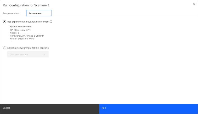

  2. Click the Run configuration icon next to the Run button to open the Run configuration pane and select the Environment tab.
  3. Choose Select run environment for this scenario, select an existing environment from the drop-down menu, and click Run.
    Environment tab of Run Configuration pane for scenario 1
    The Environment tab in this pane also shows you the default run environment that is being used for your experiment.
