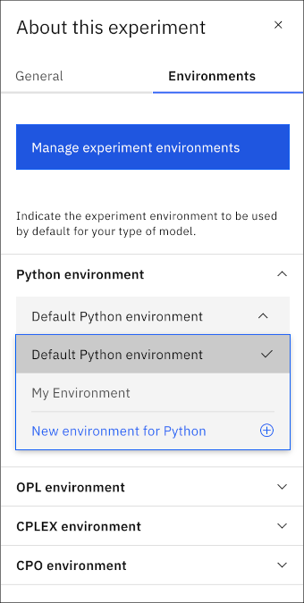

  1. Open the Overview, click the information icon information icon to open the Information pane, and select the Environments tab.
    Environment tab of information pane
  2. Expand the environment section according to your model type. For Python and Modeling Assistant models, expand Python environment. You can see the default Python environment (if one exists). To change the default environment for OPL, CPLEX, or CPO models, expand the appropriate environment section according to your model type and follow this same procedure.
  3. Expand the name of your environment, and select a different Python environment.

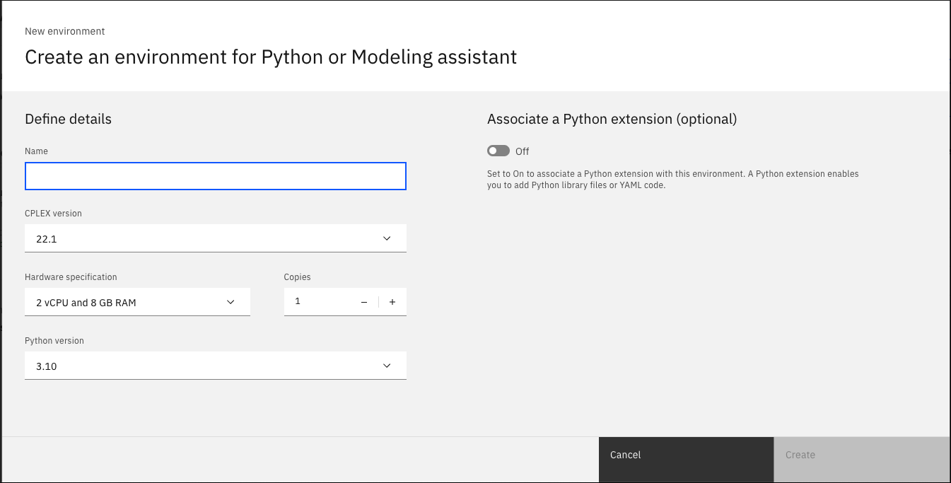

  4. Optional: To create a new environment:
    1. Select a New environment for Python.
      A new window opens for you to define your new environment. New environment window showing empty fields
    2. Enter a name, and select a CPLEX version, hardware specification, copies (number of nodes), and the Python version.

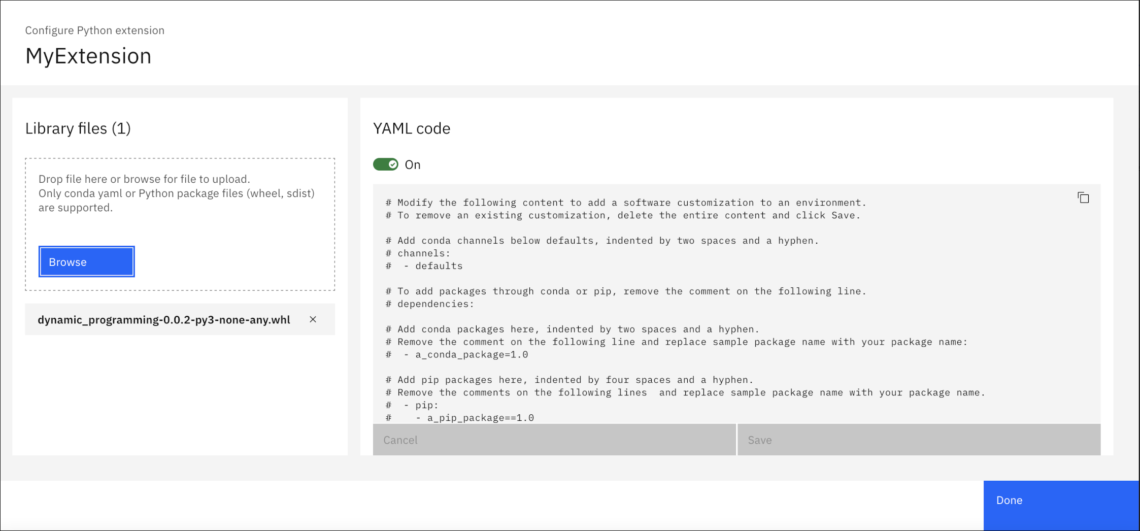

    3. Set Associate a Python extension to On to include any Python libraries that you want to add.
    4. Click New Python extension.
    5. Enter a name for your extension in the new Create a Python extension window that opens, and click Create.
    6. In the new Configure Python extension window that opens, you can set YAML code to On and enter or edit the provided YAML code.
      For example, use the provided template to add the custom libraries:
      # Modify the following content to add a software customization to an environment.
      # To remove an existing customization, delete the entire content and click Apply.
      # Add conda channels on a new line after defaults, indented by two spaces and a hyphen.
      channels:
        - defaults
      # To add packages through conda or pip, remove the comment on the following line.
      # dependencies:
      # Add conda packages here, indented by two spaces and a hyphen.
      # Remove the comment on the following line and replace sample package name with your package name:
      #  - a_conda_package=1.0
      # Add pip packages here, indented by four spaces and a hyphen.
      # Remove the comments on the following lines  and replace sample package name with your package name.
      #  - pip:
      #    - a_pip_package==1.0
      You can also click Browse to add any Python libraries.
      For example, this image shows a dynamic programming Python library that is imported and YAML code set to On.Configure Python extension window showing YAML code and a Dynamic Programming library included
      If necessary, modify the YAML code and click Save.
      Click Done.

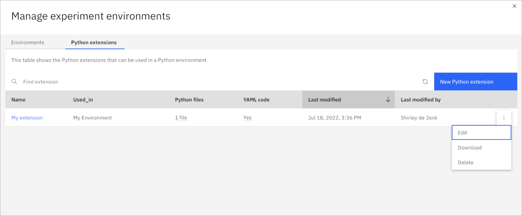

  6. Click the Python extensions tab.
    Python extensions tab showing created extension
    Here you can view your Python extensions and see which environment an extension is used in. You can also create a New Python extension or use the options to Edit, Download, and Delete existing ones. You can also click the extension name to configure it. If you edit a Python extension that is used by an experiment environment, the environment is re-created.
