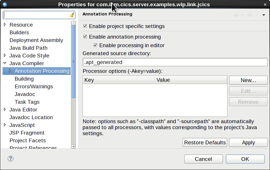

  1. Check the application to determine whether the correct artifacts have been generated.
    1. Check that annotation processing is enabled on the source project.
      Figure 1. Check annotation processing is enabled
      Check that the "Enable annotation processing" option is selected in the Java Compiler > Annotation Processing section of the project properties
