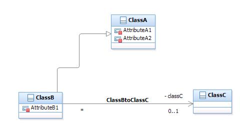

Class diagrams
Classes have attributes. These are properties that you can use to describe an instance of that class, and to differentiate one instance of the class from another.
Classes can have associations to other classes. You use these associations to represent functional, or otherwise meaningful, relationships between objects. WSRR Studio uses directed associations, to represent relationships between objects. Directed associations are one-way, in that the relationship can be traversed only from its source to the target. For example, in Figure 1, ClassB has a relationship with ClassC, but ClassC does not have a relationship with ClassB because the association is one-way, and directed from ClassB to ClassC.
Classes can be generalizations of other classes. This means that one class can be a subclass of another class, called its superclass; the subclass inherits all of the attributes of the superclass, in addition to its own attributes. For example, in Figure 1, ClassB is a generalisation of ClassA. This means that ClassB inherits all of the attributes of ClassA, so any instance of ClassB has attributes AttributeA1 and AttributeA2, in addition to AttributeB1.
By using these modelling constructs, you can graphically represent many of the concepts and objects that are contained in WSRR.
