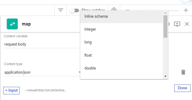

- Click the Edit inputs icon.
- Click + input.
- Configure the input according to the following table:
Table 1. JSON input Property Value Context variable request.body Name input Content type application/json Definition Inline schema

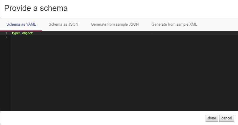

- A dialog pane opens. Click Generate from sample JSON.
- Paste the following sample JSON into the box.
{"order": {"customer": {"name": { "firstname":"John", "middlename":"Q", "lastname":"Smith" }, "address": { "line1":"550 King St", "line2":"Dept 5", "city":"Littleton", "state":"MA", "country":"USA", "code":"01460" } } }, "items": [{"item":"shoes", "color":"black", "qty":2, "price":23.50}, {"item":"socks", "color":"argyle", "qty":2, "price":3.95}, {"item":"pants", "color":"grey", "qty":1, "price":48.00}] }
- Click generate.
- The OpenAPI code to describe the schema appears. Click done. The dialog box closes.

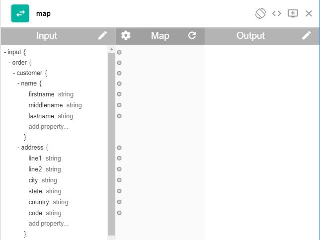

- Click the handle alongside the date field in the Output column. A dialog box opens.
- Enter the following JavaScript code in the box;
new Date().toGMTString(), then click ok.
- Click the handle alongside the firstname field in Input and click the handle alongside the customer field in Output.
- Click the handle alongside the middlename field in Input and click the handle alongside the customer field in Output.
- Click the handle alongside the lastname field in Input and click the handle

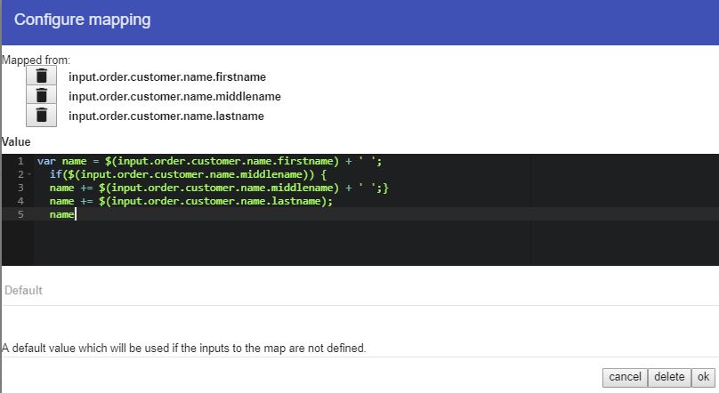

- Click the handle alongside the customer field in Output. A dialog box opens.
- Enter the following code in the box. Click ok.
var name = $(input.order.customer.name.firstname) + ' '; if($(input.order.customer.name.middlename)) { name += $(input.order.customer.name.middlename) + ' ';} name += $(input.order.customer.name.lastname); name

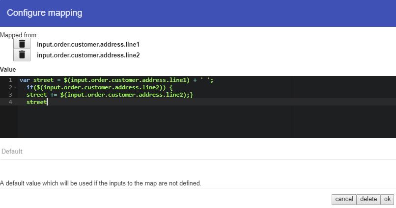

- Click the handle alongside street in Output. This opens a dialog box.
var street = $(input.order.customer.address.line1) + ' '; if($(input.order.customer.address.line2)) { street += $(input.order.customer.address.line2);} street

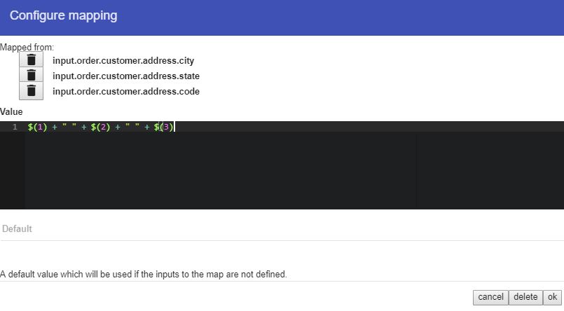

- Click the handle alongside the city field in Input and click the handle alongside the citystatezip field in Output.
- Click the handle alongside the state field in Input and click the handle alongside the citystatezip field in Output.
- Click the handle alongside the code field in Input and click the handle
- Click the handle alongside the citystatezip field in Output. A dialog box opens.
- Enter the following code in the box. Note that the variable references are positional; $(1)
refers to the first mapped value (input.order.customer.city), and so on. Click
ok.
$(1) + " " + $(2) + " " + $(3)

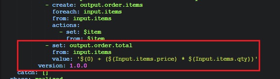

- Click Source.
- Drag the highlighter to the end of the Source.
- Locate the code where total is calculated.
- Insert a new line with the code foreach: input.items.
- Click the Save icon to save these changes.
