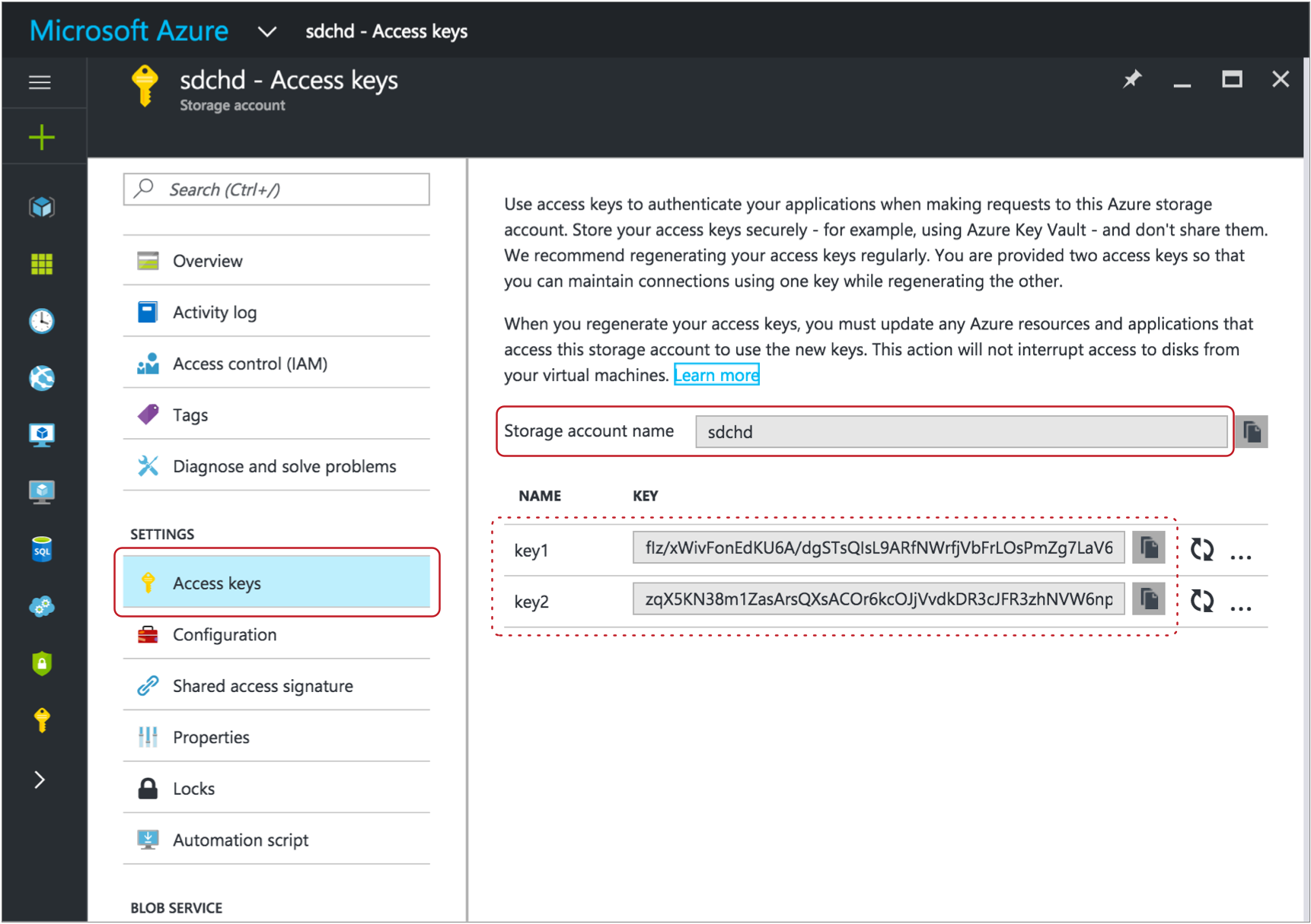

- In the Name property, enter the Azure
storage account name as
follows:
For example, if the storage account name isfs.azure.account.key.<storage account name>.blob.core.windows.netsdchd, then enter the following name for the property:fs.azure.account.key.sdchd.blob.core.windows.netTip: You can find the Azure storage account name on the Access Keys page in the Microsoft Azure portal. To view the page in the Microsoft Azure portal, click . A page like the following appears, with the storage account name and access keys:
- In the Value property, enter an access
key value for the Azure storage account. You can use any valid key.Tip: The account key value also displays on the Access Keys page. For example, on the image above, you could use either the key1 or key2 value.

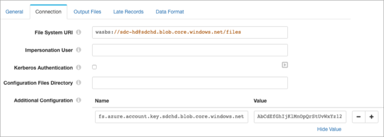

- On the Connection tab, configure the File System
URI property as
follows:

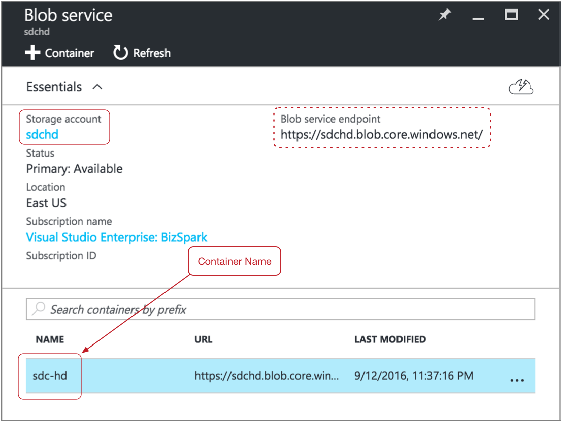

<wasb[s]>://<container name>@<storage account name>.blob.core.windows.net/<path to files>In the URI, <container name> is the Azure container name, and <storage account name> is the Azure storage account name.
For example, for asdc-hdcontainer in a storage account namedsdchd, with all files in a files directory, you would define the file system URI as follows:wasbs://sdc-hd@sdchd.blob.core.windows.net/filesTip: You can find the container name and storage account name on the Essentials page in the Microsoft Azure portal. For a standard storage account, in the Microsoft Azure portal, click . For a blob storage account, click .The page shows the container name and storage account name:
Though the host name for the file system URI is
<storage account name>.blob.core.windows.net, you can alternatively use the host name of the Azure blob service endpoint as the host name for the file system URI.
Example
The following image shows how to configure the Hadoop FS destination to write to Azure Blob storage with HDInsight using the Azure account information in the examples above:
