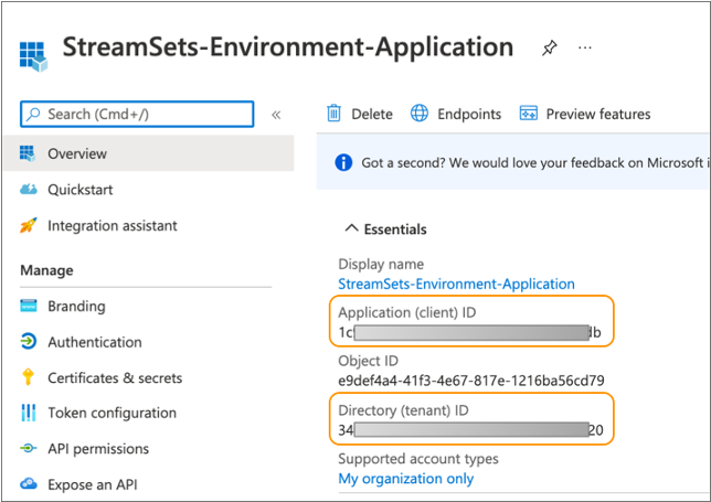

  8. In the Overview tab for the application, copy the following values:
    • Application (client) ID
    • Directory (tenant) ID
    Values to copy from the Overview tab for the application
    You will enter these values when you create the Azure environment in Control Hub.

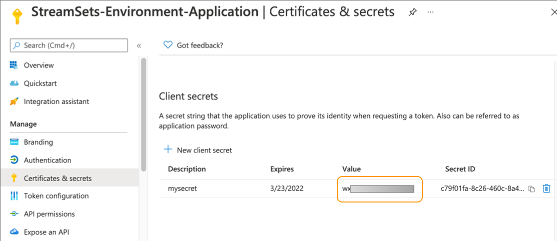

  9. In the left navigation, click Certificates & secrets.
  10. Under Client secrets, click New client secret.
  11. Enter a description for the secret, and select a duration.
    Important: Choose a duration that matches the amount of time you anticipate using the Azure environment in Control Hub. When the secret expires, you must create a new secret and then update the environment in Control Hub.
  12. Click Add.
  13. Copy the displayed value for the secret.
    Client secret generated for the application
    You will enter the client secret when you create the Azure environment in Control Hub.

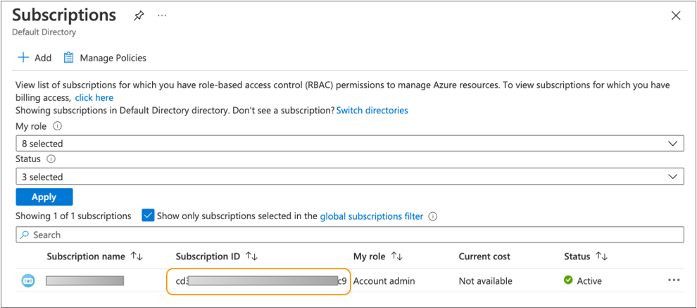

  1. In the Azure portal, enter Subscriptions in the services search field.
  2. Click Subscriptions.
  3. In the list of subscriptions, copy the subscription ID where you want Control Hub to provision Azure resources.
    List of subscriptions in the Azure portal
    You will enter the subscription ID when you create the Azure environment in Control Hub.

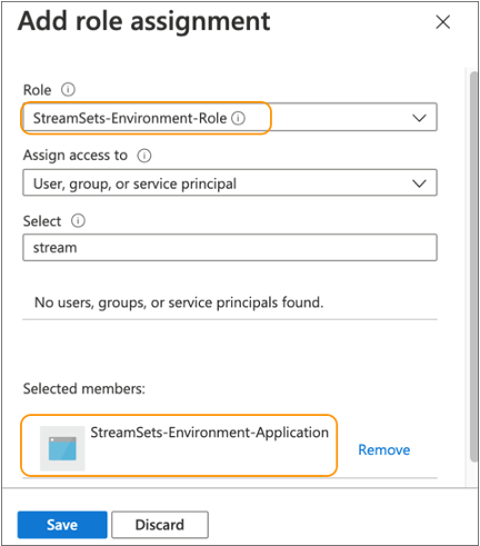

  13. With Access control (IAM) selected in the left navigation, click Add > Add role assignment.
  14. Search for and then select the role that you created for IBM StreamSets environments.
    For example, select StreamSets-Environment-Role.
  15. For Assign access to, select User, group, or service principal.
  16. Search for and then select the application or service principal that you created for IBM StreamSets environments.
    For example, select StreamSets-Environment-Application, as follows:
    Assigning the role to the IBM StreamSets application
  17. Click Save.

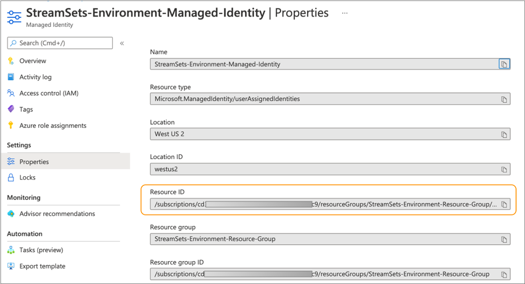

  9. Click the managed identity name, and then in the left navigation, click Settings > Properties.
  10. Copy the Resource ID of the managed identity.
    Resource ID displayed in the managed identity properties
    You will enter the managed identity resource ID when you create the Azure environment in Control Hub.

    Client ID Client (application) ID of the Azure application registered as a prerequisite by your Azure administrator.
    When an application is registered, a service principal is automatically created. The service principal functions as the identity of the application instance.
    Client Secret Client secret of the Azure application created as a prerequisite by your Azure administrator.
    Control Hub uses the service principal with this client secret to authenticate with Azure.
    Tenant ID Tenant (directory) ID of the Azure application registered as a prerequisite by your Azure administrator.
    Subscription ID Subscription ID where you want Control Hub to provision Azure resources for all deployments belonging to this environment.

    Default Managed Identity Optional managed identity to associate with the VM instances provisioned for all deployments belonging to this environment. Enter the resource ID of the managed identity created as a prerequisite by your Azure administrator. Use the following format:
    /subscriptions/<subscription ID>/resourceGroups/<resource group name>/providers/Microsoft.ManagedIdentity/userAssignedIdentities/<managed identity name>
    If you do not define a default managed identity, then you must define a managed identity when you create a deployment for this environment.
