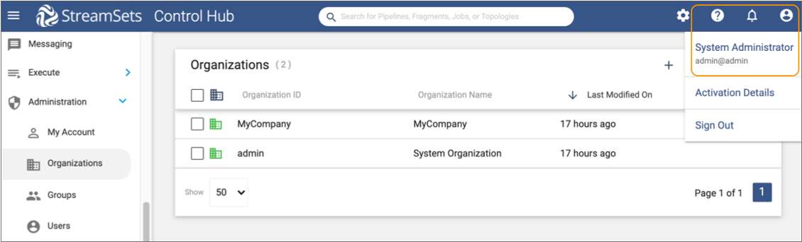

After starting Control Hub, log in to the instance and create the required organizations.
Control Hub also includes a separate Admin tool to monitor and troubleshoot Control Hub issues. For example, if Control Hub becomes inaccessible, the Admin tool remains running. You can still log into the Admin tool to troubleshoot the Control Hub issues.

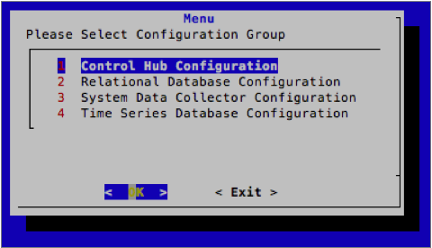

Step 6. Set Up Control Hub
Run the Control Hub setup script to configure Control Hub properties, database connection details, and optionally the system Data Collector properties. The setup script uses the dialog command line utility to display the configuration properties using dialog boxes.
Important: The script writes all property values to the Control Hub configuration files. Instead of entering sensitive data such as passwords in clear text in the setup script, you can protect the sensitive data by storing the data in an external location and then using functions to retrieve the data.
  1. Install the dialog command line utility.
    For CentOS, Oracle Linux, or Red Hat Enterprise Linux, use the following command:
    yum install dialog
    For Ubuntu, use the following commands:
    apt-get update
    apt-get install dialog
  2. If using PuTTY as the SSH client to install Control Hub on a remote machine, configure PuTTY to use linux as the terminal emulation mode.
    By default, PuTTY uses xterm emulation which does not correctly display the dialog command line utility.
    In the PuTTY Configuration dialog box, click Connection > Data and then set Terminal-type string to linux.
  3. Use the following command to run the Control Hub setup script from the $DPM_HOME directory:
    dev/setup.sh
When you run the script for the first time, configure all of the properties. If necessary, you can run the script again to change a few properties, navigating to the appropriate configuration group.
See the sections below for a description of each property.

The Control Hub setup script contains multiple configuration groups that you navigate through to configure the required properties. The initial dialog box displays the configuration groups:
Use the arrow keys, the numbers assigned to each section, and the OK, Cancel, and Back options to navigate through the dialog boxes. Type a number to jump to that section rather using arrow keys to cycle through each section.
In dialog boxes that offer a selection of two options, use the space bar to select another option. Let's look at the Mail Transport Protocol dialog box:
In this example, the SMTP protocol is currently set, as displayed by the asterisk (*) next to the option. To change to the SMTPS protocol, press the down arrow or the number 2 to highlight SMTPS. Then press the space bar to switch the selection - the screen displays the asterisk next to the SMTPS option. Then press Enter with the OK option highlighted to save your selection.
Control Hub Configuration

Step 12. Log Into Control Hub
After launching Control Hub, log in to Control Hub using the default system administrator account.
  1. Enter the Control Hub base URL in the address bar of your browser.
    You defined the base URL when you ran the Control Hub setup script. After you start Control Hub, the first URL listed in the command output is the base URL:
    http://<host name>:18631
    The second URL listed in the command output is the URL to the Control Hub Admin tool, which you can use to monitor and troubleshoot Control Hub issues. No need to log into that tool now, we'll explore it in more detail in Control Hub Admin tool.
  2. Use the following credentials to log in as the default system administrator: admin@admin / admin@admin.
    Control Hub displays the default dashboard:
    The system administrator is a user account that belongs to the system organization. The system administrator can complete tasks across all Control Hub organizations.
  3. Immediately after logging in as the system administrator, change the default password for the account to ensure the integrity of your data.
