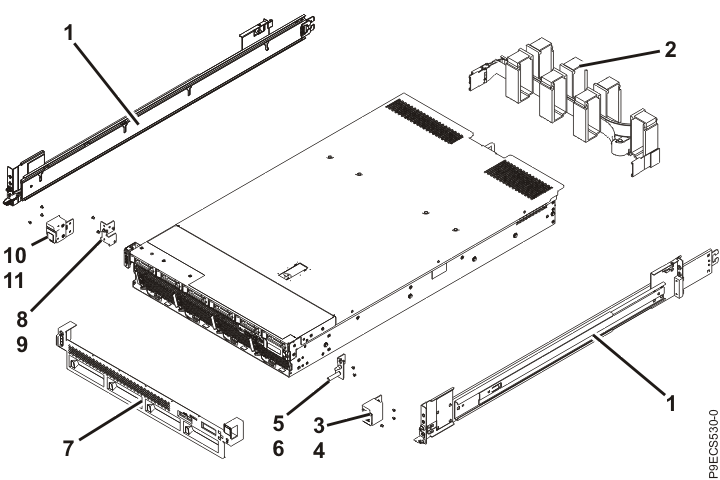

Rack final assembly
Cover assembly
Table 1. Rack assembly part numbers
Index number CCIN Part number Units per assembly Description
1   01GY478 1 Slide rail kit - contains left and right slide rails and attaching screws
2   01GY476 1 Cable management arm assembly
3     1 Electronic Industries Association (EIA) latch (right)
4     3 Screws
5     1 EIA bracket (right)
6     2 Screws
7   01ML069 1 Front bezel
  02DE781 1 Front bezel (Only for the 9009-22G or 9223-22S system with the NVMe drive backplane)
8     1 EIA bracket (left)
9     1 Screws
10     1 EIA latch (left)
11     3 Screws

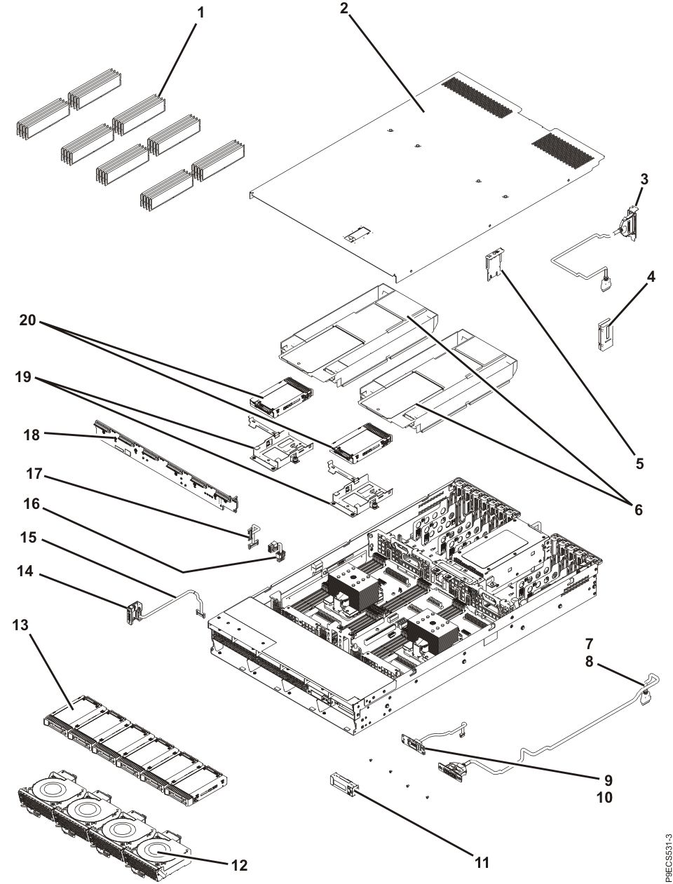

Table 2. System parts
1 324D 78P4191 4-32 8 GB ISDIMM
324E 78P4197 4-32 16 GB ISDIMM
324F 78P4198 4-32 32 GB ISDIMM
325A 78P4199 4-32 64 GB ISDIMM (8 Gb memory density)
32BB 78P6815 4-32 64 GB ISDIMM (16 Gb memory density)
Note: The system firmware level must be FW950.xx, or later.
324C 78P4200 4-32 128 GB ISDIMM (8 Gb memory density)
32BC 78P6925** 4-32 128 GB ISDIMM (16 Gb memory density and manufactured by SK Hynix, Inc.)
Note: The system firmware level must be FW950.00, or later.
32BC 78P7468** 4-32 128 GB ISDIMM (16 Gb memory density and manufactured by Samsung Electronics Co., Ltd.)
Note: If you are installing the 128 GB ISDIMM in a new or existing configuration so that the resulting configuration will have more than half of the allowable memory module locations populated, the system firmware level must be FW950.50, or later. Otherwise, the system firmware level must be FW950.00, or later.
  01GY204 0-28 DIMM filler
2     1 Top cover assembly
3   01KL674 1 Rear USB cable and connector
4 563C 01DH178 1 Vital product data card (9008-22L)
563A 01DH176 1 Vital product data card (9009-22A or 9223-22H)
565C 02WG640 1 Vital product data card (5105-22E, 9009-22G, or 9223-22S)
5 6B5A 1 Trusted platform module
Notes:
  • For systems with system firmware level earlier than FW950.C0, order part number 00VK519.
  • For systems with system firmware level FW950.C0 or later, order part number 03PK608.
6     2 Air baffles
7   01KL673 1 Front USB cable and connector
8     2 Screws
9   01ML097 1 Control panel display cable and holder
10     2 Screws
11 6B5D 00VK547 1 Control panel display
12 6B5F 01GY151 4 Fan
13     8 Disk drive. See Disk drive and solid-state drive system parts.
13 5947 01LU974 0-4 800 GB NVMe U.2 drive (9009-22G)
Note: Supported only on the IBM® i operating system.
13 5949 02YC661 0-4 800 GB NVMe U.2 drive (9009-22G or 9223-22S)
Note: Supported only on the AIX® and Linux® operating systems.
13 59B7 02YC615 0-4 800 GB NVMe U.2 drive (9009-22G or 9223-22S)
Note: Supported only on the AIX and Linux operating systems.
13 59B8 01LU967 0-4 1600 GB NVMe U.2 drive (9009-22G or 9223-22S)
13 59B9 01LU968 0-4 3200 GB NVMe U.2 drive (9009-22G or 9223-22S)
13 59BA 01LU969 0-4 6400 GB NVMe U.2 drive (9009-22G or 9223-22S)
14 6B5C 00VK541 1 Control panel
15   01GY455 1 Control panel cable
16   01ML051 1 Disk drive backplane and NVMe backplane power cable
17   01ML052 1 Disk drive backplane and NVMe backplane signal cable
18 2D36 01DH189 1 Disk drive backplane
2D3B 01DH247 1
NVMe drive backplane (9009-22G or 9223-22S)
Note: The NVMe drive backplane has 4 drive connectors.
19   01GY241 2 Internal disk drive tray
20     0-2 Internal disk drive. See Disk drive and solid-state drive system parts.

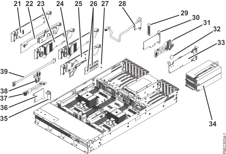

Table 3. Additional system parts
21   02WG645 0-2 NVMe U.2 pass-thru card (9009-22G or 9223-22S)
22 57DC   0-1 Backup power module card
Note: The backup power module card is included with the expanded function RAID adapter (PCIe3 x8 cache SAS RAID internal adapter) part number. Replace the PCIe3 x8 cache SAS RAID internal adapter and the backup power module card together.
23 57DC 01JC780 0-1 Expanded function RAID adapter (includes backup power module card)
24 57D7 01LK399 0-2 Base function RAID adapter
25   01DH181 0-2 NVMe M.2 carrier card (9008-22L, 9009-22A, or 9223-22H)
26   00LY537 0-4 NVMe M.2 flash module (9008-22L, 9009-22A, or 9223-22H)
27     0-1 Screw
28   01ML060 0-1 Rear SAS cable and bracket
29   00E7338   Adapter filler
30       Adapter. Use the feature code of the adapter to find the FRU number in Adapter information by feature code.
31   00E7333   Adapter divider
32   44V4359 1 Time-of-day battery
33 2DEA   1 Service processor card
Notes:
  • For systems with system firmware level FW910.xx, order part number 01DH338.
  • For systems with system firmware level FW930.xx or FW940.xx, order part number 02PX060.
  • For systems with system firmware level FW941.xx, order part number 02AU384.
  • For systems with system firmware level FW950.xx, order part number 02PX093.
34 2B1D 03FP372 2 900 W power supply (9009-22G or 9223-22S)
2B1E   2 1400 W or 1600 W power supply
Notes:
  • For a system with 1400 W power supplies, order part number 03FP302.
  • For a system with 1600 W power supplies, order part number 03FP728.
  • 1400 W power supplies and 1600 W power supplies are not interchangeable.
35   01GY494 0-1 SAS cable slot filler
36   01GY502 0-1 SAS divider
37   01GY461 0-1 Front SAS Y cable (expanded function)
38   01GY462 0-2 Front SAS cable (base function)
39   02DE774 0-2 NVMe cable

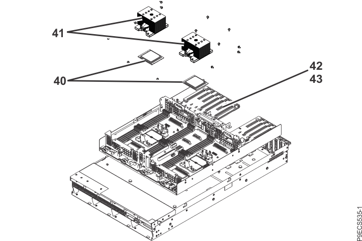

Table 4. Additional system parts (continued)
40 5C22 01ML131* 1-2 System processor module kit (includes 4 core processor module, processor handling tool, 4mm Hex driver, TIM, tweezers, and air pump) (9009-22A or 9223-22H)
5C3A 02DE685* 1-2 System processor module kit (includes 1-4 core processor module, processor handling tool, 4mm Hex driver, TIM, tweezers, and air pump)
Notes:
  • The processor is a 1 core processor for the 9009-22G system with the IBM i operating system.
  • The processor is a 4 core processor for the 9009-22A, 9009-22G, or 9223-22H system with the AIX operating system.
5C27 01ML127* 1-2 System processor module kit (includes 8 core processor module, processor handling tool, 4mm Hex driver, TIM, tweezers, and air pump) (9008-22L, 9009-22A, or 9223-22H)
5C3B 02DE682* 1-2 System processor module kit (includes 8 core processor module, processor handling tool, 4mm Hex driver, TIM, tweezers, and air pump) (9008-22L, 9009-22A, 9009-22G, 9223-22H, or 9223-22S)
5C24 01ML124* 1-2 System processor module kit (includes 10 core processor module, processor handling tool, 4mm Hex driver, TIM, tweezers, and air pump) (9008-22L, 9009-22A, or 9223-22H)
5C3C 02DE680* 1-2 System processor module kit (includes 10 core processor module, processor handling tool, 4mm Hex driver, TIM, tweezers, and air pump) (9008-22L, 9009-22A, 9009-22G, 9223-22H, or 9223-22S)
40 5C61 03FP050* 1-2 System processor module kit (includes 11 core processor module, processor handling tool, 4mm Hex driver, TIM, tweezers, and air pump) (9009-22A)
5C63 03FP048* 1-2 System processor module kit (includes 11 core processor module, processor handling tool, 4mm Hex driver, TIM, tweezers, and air pump) (9009-22A, 9009-22G, or 9223-22S)
5C26 01ML121* 1-2 System processor module kit (includes 12 core processor module, processor handling tool, 4mm Hex driver, TIM, tweezers, and air pump) (9008-22L)
5C3D 02DE678** 1-2 System processor module kit (includes 12 core processor module, processor handling tool, 4mm Hex driver, TIM, tweezers, and air pump) (9008-22L or 9009-22G)
5C3D 02FJ803** 1-2 System processor module kit (includes 12 core processor module, processor handling tool, 4mm Hex driver, TIM, tweezers, and air pump) (9223-22S)
5C4B 02DE688* 1-2 System processor module kit (includes 20 core processor module, processor handling tool, 4mm Hex driver, TIM, tweezers, and air pump) (5105-22E)
41   01EM317   Heat sink kit (includes heat sink, TIM, and tweezers)
42 2D36 01EK965 1 System backplane (9008-22L, 9009-22A, or 9223-22H)
2E2C   1 System backplane (5105-22E, 9009-22G, or 9223-22S)
Notes:
  • For systems with system firmware level FW941.xx or for systems where the firmware level is not known, order the same part number as the system backplane that you are replacing.
  • For systems with system firmware level FW950.00, order part number 03GM010.
  • For systems with system firmware level FW950.10 or later, order part number 00E5437.
43     12 Screws
* Use the CCIN of the system processor module that you are replacing to determine the correct system processor module kit to order.
** Order the same part number as the part that you are replacing.

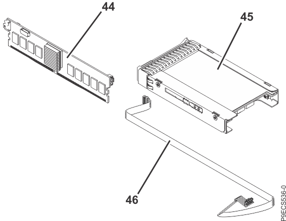

Table 5. Additional system parts for the 5105-22E
44 330A 78P6756 0-4 16 GB NVDIMM (5105-22E)
45   03FP003 0-2 Backup power module (BPM) for NVDIMM (5105-22E)
46   03FP027 0-4 BPM cable for NVDIMM (5105-22E)
