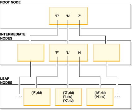

A B+ tree has several levels, as shown in Figure 1; rid refers to a record ID (RID).
Figure 1. Structure of a B+ Tree Index
Structure of a B+ tree index
The top level is known as the root node. The bottom level consists of leaf nodes that store index key values with pointers to the table rows that contain the corresponding data. Levels between the root and leaf node levels are known as intermediate nodes.
When it looks for a particular index key value, the index manager searches the index tree, starting at the root node. The root node contains one key for each (intermediate) node in the next level. The value of each of these keys is the largest existing key value for the corresponding node at the next level. For example, suppose that an index has three levels, as shown in the figure. To find a particular index key value, the index manager searches the root node for the first key value that is greater than or equal to the search key value. The root node key points to a specific intermediate node. The index manager follows this procedure through each intermediate node until it finds the leaf node that contains the index key that it needs.
Suppose that the key being looked for in Figure 1 is I. The first key in the root node that is greater than or equal to I is N, which points to the middle node at the next level. The first key in that intermediate node that is greater than or equal to I is L, which, in turn, points to a specific leaf node on which the index key for I and its corresponding RID can be found. The RID identifies the corresponding row in the base table.
