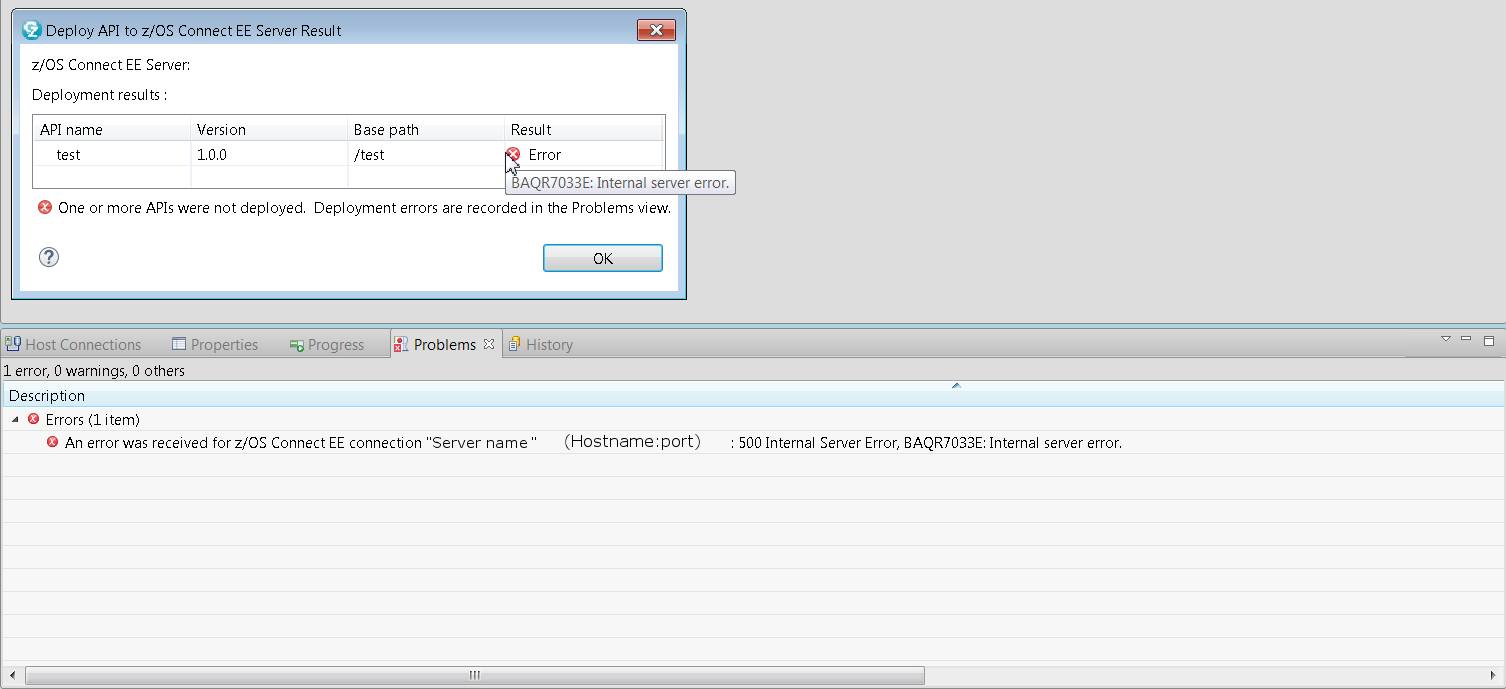

In the API deployment result dialog, check for the following error message:
In the Problems view, check for the following error message:
The following message might also be written on start up of the z/OS Connect EE server:
In addition to the previous errors, z/OS Connect EE server logs will contain the following Null Pointer Exception:
BAQR7033E: Internal server error.
An error was received for z/OS Connect EE connection "your_server_name" (server_hostname:port): 500 Internal Server Error, BAQR7033E: Internal server error
CWWKE0701E:[com.ibm.zosconnect.internal.ApiManagerImpl(316)] The activate method has thrown an exception Bundle:com.ibm.zosconnect (id=119) java.lang.NullPointerException
The following image demonstrates how these errors are recorded and displayed in the API deployment result dialog (top) & the Problems view (bottom):
