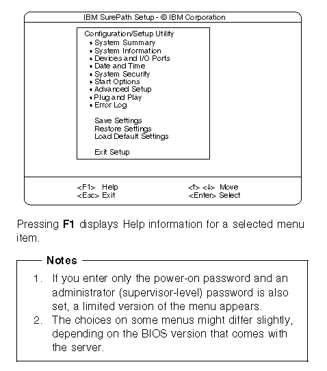

Configuration/Setup Utility Main Menu
The Configuration/Setup utility program Main Menu lets you select settings you want to change.
configuration utility main menu
To change configuration settings:
  1. Use the Up Arrow or Down Arrow keys to select the menu item for the configuration setting you want to change. Selected items are highlighted. Then press Enter.
  2. Select the configuration setting you want to change. Use the Page Up (PgUp) and Page Down (PgDn) keys to scroll through the menu, if needed.
  3. Use the Right Arrow or Left Arrow keys to select the appropriate setting for the selected item.
  4. Repeat Steps 1 through 3 for each setting you want to change. Press Esc to return to the Configuration/Setup Main Menu.
  5. After making changes, you can select Save Settings to save the selected changes, Restore Settings to delete the changes and restore the previous settings, or Load Default Settings to cancel the changes and restore the factory settings.
  6. To exit from the Main Menu, select Exit Setup. The system prompts you to confirm your choice. You can return to the Main Menu, or save your changes and exit, or exit without saving your changes; the Diagnostic/Setup utility menu displays.
