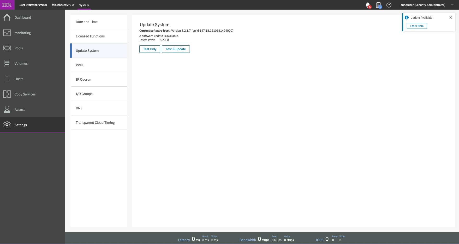

When updating systems running releases v8.x and later:
- From the Dashboard, select Settings > System in the GUI
- Select "Update System"
- You can choose to "Update and Test" or just run the utility tool using the "Test Only" button (please details for this at the bottom of the page).
- Click the "Update and Test" button.
- When prompted, upload the Test utility package and the Update package files and then click "Next" as shown in the following screenshot
- The following panel will ask you to select the type of update. You can choose between an automatic update or a service assistant manual update.
- To proceed after your selection click "Next" to start uploading the packages.
- If there are no warning(s) or error(r)s detected the system update will continue and start updating system nodes / node canisters.

When running the utility using the Graphical user interface (GUI) only:
From V8.1.0 and onwards the utility can be installed and run in the GUI on its own.
- Select Test Only from the Update System page
- Upload the Test utility file and enter the Code level you are planning to update to.
Click "Test" - After the Update Test Utility completed, you will be presented with the results.
- The results will either state that there have been no warnings / problems found, or will direct you to details about any known issues which have been discovered on the system.
