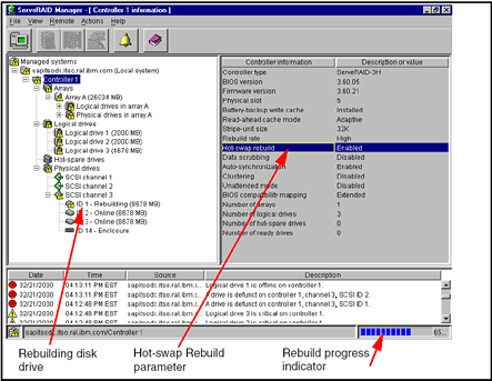

- While the system is powered on, identify the defunct physical drive to be replaced in one of the following ways: A solid Amber drive LED indicator will be on Using ServeRAID Manager, right click on the defunct drive and choose "Identify Drive". This will flash the drive LED and make it easier to locate the physical drive in larger configurations.

- Within a few minutes, ServeRAID should detect the hot-swap event and, depending on the configuration, take one of the following actions:
- If no Hot Spare or Standby Hot Spare was previously defined, ServeRAID should automatically initiate a rebuild to the replacement disk
- If a Hot Spare or Standby Hot Spare was previously defined, ServeRAID should automatically set the state of the replacement disk to a Hot Spare or Standby Hot Spare respectively
- If the hot-swap rebuild BIOS setting has been disabled, you will need to manually rebuild the hard disk drive

Note: These state transitions can be observed in real time using ServeRAID Manager.

Use ServeRAID Manager to manually initiate a rebuild operation or change the state of the drive to a hot spare. This is done by right clicking on the defunct drive that was recently replaced and select the rebuild operation or to change the state of the disk as appropriate.
