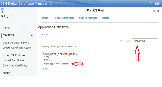

  2. Log into DCM (http://systemname:2006 or https://systemname:2007/dcm).
  3. Click 'Open Certificate Store', then click *SYSTEM and provide the password.
  4. Click on 'Manage Application Definitions'.
  5. Type the application ID found in the HTTP Apache configuration 'SSLAppName' directive in the Search form field. If no application definition exists, it is possible that application definition does not exist or the 'SSLAppName' directive has the wrong application definition name
    checkthisout
  6. If you notice No certificates assigned, you will need to assign one.  For information on assigning a certificate, click here
  7. If there is a certificate assigned, you will want to check to see in the certificate is expired. To check, click on Manage Certificates and locate the certificate. If the certificate is expired, you may want to renew it.  If the certificate was signed locally, click here. If the certificate was signed by a Certificate Authority external to the IBM i, click here.
