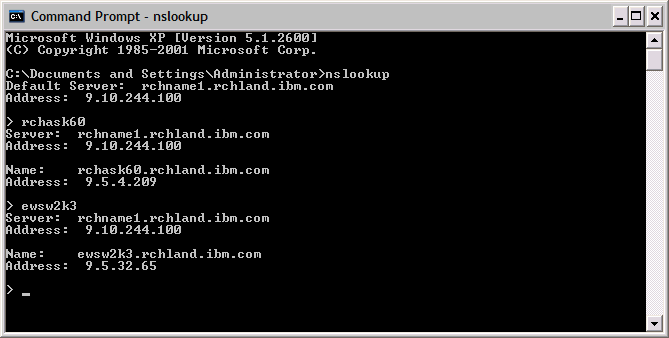

Be sure all the DNS records are configured in your network DNS server (A, PTR).
DNS Records
1. Open a DOS window and type nslookup.
2. Once in the nslookup shell, type the name of the IBM i system name that you will be connecting to and press Enter:
3. Do the same for the Windows Active Directory server:
4. Check for the PTR records by typing set type=ptr and pressing Enter. Then type the IP address that was returned for the IBM i name earlier.
You should have a record like the above example.
