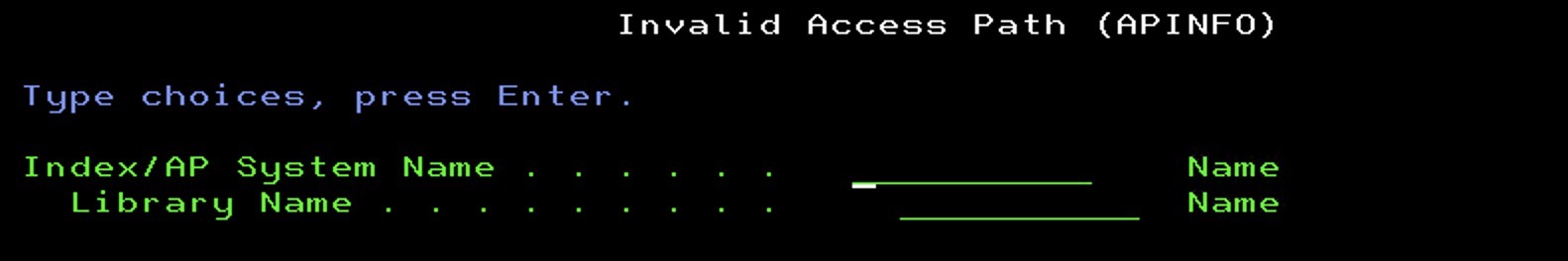

6. Option 7 - Invalid Access Path
InvalidAccessPath_screen
7. Enter in the SQL Index or logical file that you are investigating.
