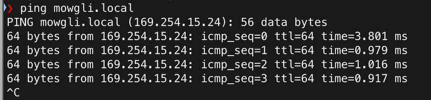

3. Ping mowgli.local to get the IP address
In this example, the IP shows to be 169.254.15.24.
The IP shown in your case, will be different.
ping output
