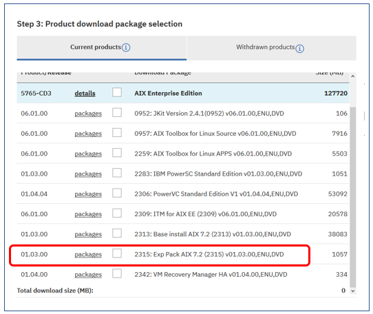

library is available in IBM AIX® 7.2 with Technology Level 4 Expansion Pack, and later.So, you'll need the Expansion Pack.
See the Release Notes.
It can be downloaded from the ESS website:
![ESS for Expansion Pack](/support/pages/system/files/inline-images/image_4864.png)
You don't need to install all of the Expansion Pack for this exercise, just zlibNX (7.2.4.0 NX accelerated zlib compression library )

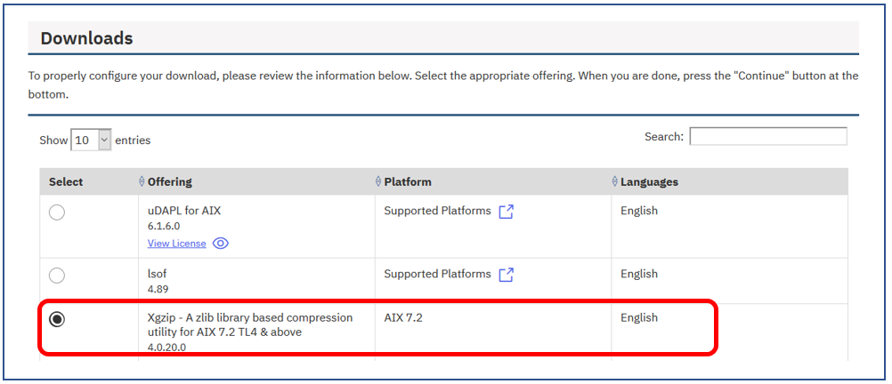

For testing, I used xgzip. It is available from the AIX Web Download Pack.
![xgzip on IBM Web Download Pack](/support/pages/system/files/inline-images/image_4865.png)
You download it into a directory, cd into the directory, run "inutoc ." and then smitty install_latest.
