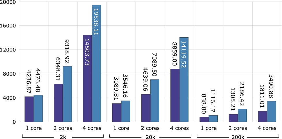

HTTP BLOB Echo
![Message Rate [1/s]](/support/pages/system/files/inline-images/linux-rate-http.echo_.blob__0.png)
| Message Size | Concurrency | IBM Integration Bus 10.0.0.18 | IBM App Connect Enterprise 11.0.0.6 | ||
| Rate | CPU cost | Rate | CPU cost | ||
| 2k | 1 | 4236.87/s | 235.89 μs | 4476.48/s | 223.91 μs |
| 2 | 6348.31/s | 240.73 μs | 9318.92/s | 213.96 μs | |
| 4 | 14503.73/s | 236.79 μs | 19538.11/s | 201.34 μs | |
| 20k | 1 | 3089.81/s | 323.44 μs | 3546.16/s | 282.67 μs |
| 2 | 4639.06/s | 350.62 μs | 7089.50/s | 280.56 μs | |
| 4 | 8859.00/s | 371.36 μs | 14119.52/s | 274.92 μs | |
| 200k | 1 | 838.80/s | 1.19 ms | 1116.17/s | 898.56 μs |
| 2 | 1305.21/s | 1.39 ms | 2186.42/s | 916.13 μs | |
| 4 | 1811.01/s | 2.09 ms | 3490.88/s | 1.12 ms | |

| 2 | 910.08/s | 1.82 ms | 651.07/s | 2.52 ms | |
| 4 | 1912.26/s | 1.69 ms | 1406.09/s | 2.31 ms | |
| 200k | 1 | 51.58/s | 16.64 ms | 34.28/s | 24.98 ms |
| 2 | 97.32/s | 16.82 ms | 68.62/s | 23.97 ms | |
| 4 | 205.81/s | 15.85 ms | 145.82/s | 22.08 ms | |
MQ Coordinated Request-Reply
![Message Rate [1/s]](/support/pages/system/files/inline-images/aix-rate-mq.coreqreply.png)
| 2k | 1 | 386.58/s | 2.26 ms | 368.81/s | 2.3 ms |
| 2 | 753.48/s | 2.1 ms | 744.75/s | 2.12 ms | |
| 4 | 1464.18/s | 2.19 ms | 1512.94/s | 2.13 ms | |
| 20k | 1 | 67.54/s | 12.98 ms | 63.50/s | 13.46 ms |
| 2 | 134.45/s | 11.75 ms | 128.88/s | 12.18 ms | |
| 4 | 275.15/s | 11.65 ms | 275.93/s | 11.63 ms | |
| 200k | 1 | 7.12/s | 122.63 ms | 6.78/s | 127.19 ms |
| 2 | 14.46/s | 112.4 ms | 13.89/s | 116.55 ms | |
| 4 | 29.68/s | 108.36 ms | 28.83/s | 111.44 ms | |
MQ Large Messaging
![Message Rate [1/s]](/support/pages/system/files/inline-images/aix-rate-mq.largemsg.png)
| 2k | 1 | 1576.47/s | 529.18 μs | 1344.53/s | 623.57 μs |
| 2 | 2828.71/s | 562.99 μs | 2510.18/s | 636.62 μs | |
| 4 | 5095.42/s | 644.64 μs | 4655.89/s | 702.04 μs | |
| 20k | 1 | 255.19/s | 3.27 ms | 205.34/s | 4.08 ms |
| 2 | 463.08/s | 3.48 ms | 388.90/s | 4.14 ms | |
| 4 | 817.59/s | 3.95 ms | 725.76/s | 4.46 ms | |
| 200k | 1 | 26.86/s | 31.27 ms | 21.62/s | 38.91 ms |
| 2 | 49.03/s | 32.85 ms | 41.16/s | 38.89 ms | |
| 4 | 86.66/s | 37.19 ms | 76.95/s | 42.11 ms | |
MQ Routing Cache
![Message Rate [1/s]](/support/pages/system/files/inline-images/aix-rate-mq.routingcache.png)
| 2k | 1 | 5016.86/s | 162.44 μs | 4763.76/s | 171.19 μs |
| 2 | 10711.62/s | 165.3 μs | 9532.47/s | 173.85 μs | |
| 4 | 15392.57/s | 196.08 μs | 14772.47/s | 204.44 μs | |
| 20k | 1 | 3785.09/s | 182.28 μs | 3579.64/s | 194.23 μs |
| 2 | 5551.35/s | 186.87 μs | 5278.23/s | 195.91 μs | |
| 4 | 8285.90/s | 206.32 μs | 8218.99/s | 216.16 μs | |
| 200k | 1 | 498.15/s | 477.55 μs | 489.88/s | 484.59 μs |
| 2 | 256.95/s | 675.53 μs | 259.25/s | 688.38 μs | |
| 4 | 835.12/s | 686.74 μs | 830.52/s | 693.06 μs | |
Trademarks
