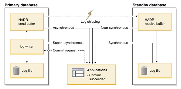

HADR sync modes are the primary dial to control C vs. A tradeoffs:
Sync Modes:
Transaction are committed on the Primary after relevant logs have been written to disk on Primary and:
| Sync Mode | Sync Mode Implication on Standby | Relation to CAP |
| SYNC | logs have been written to disk on Standby as well | Highest C (Data guaranteed on Standby) |
| NEARSYNC | Logs are received into memory on Standby | More C |
| ASYNC | Logs sent to the Standby on the Network (Don't wait for ACK) | More A |
| SUPERASYNC | Don't wait for Standby!! | Highest A (No guarantee) |
In SYNC mode, the total time for a log write = Σ (Primary_Log_Write + Log_Send + Standby_Log_Write + Ack_Message)
Figure 2: Shows the various sync modes
