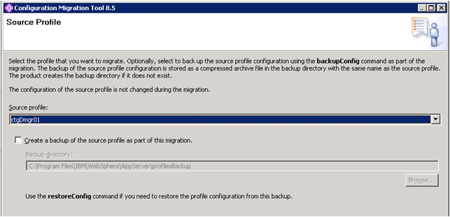

5a. Source Profile. We’ll be migrating two profiles. Start with ctgDmgr01. Since we backed up configuration before, there is no need to back it up again. Click Next.

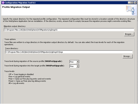

5d. Profile Migration Output. When you accept the defaults note that the new WAS 8.5 Deployment Manager will have the same name as the WAS 7.0 Dmgr. The new Deployment Manager profile we created earlier is required to run the Migration Tool, but is not used in the final product. Click Next.
