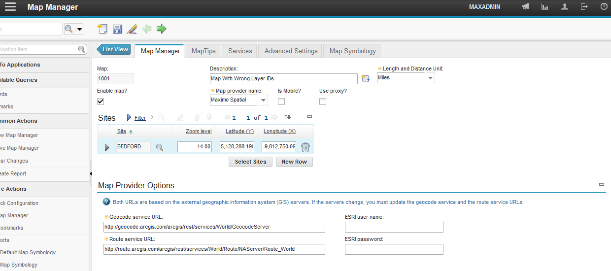

1. Go to Map Manager application.
2. Open the Map Manager record which has your Map Service configured.

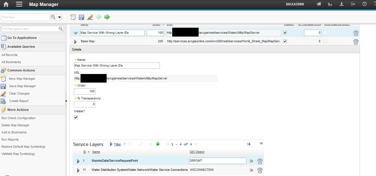

3. Scroll down to the Map Services section and expand the line which has the layers with wrong IDs.

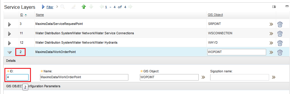

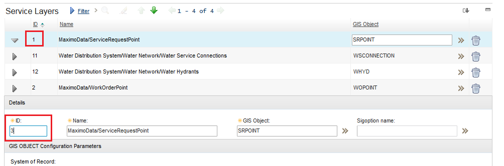

4. Scroll down to the Service Layers section and repopulate the ID fields with the values that correspond to their respective layers in the Map Service.
Changing the ID of SR layer:
Changing the ID of WO layer:

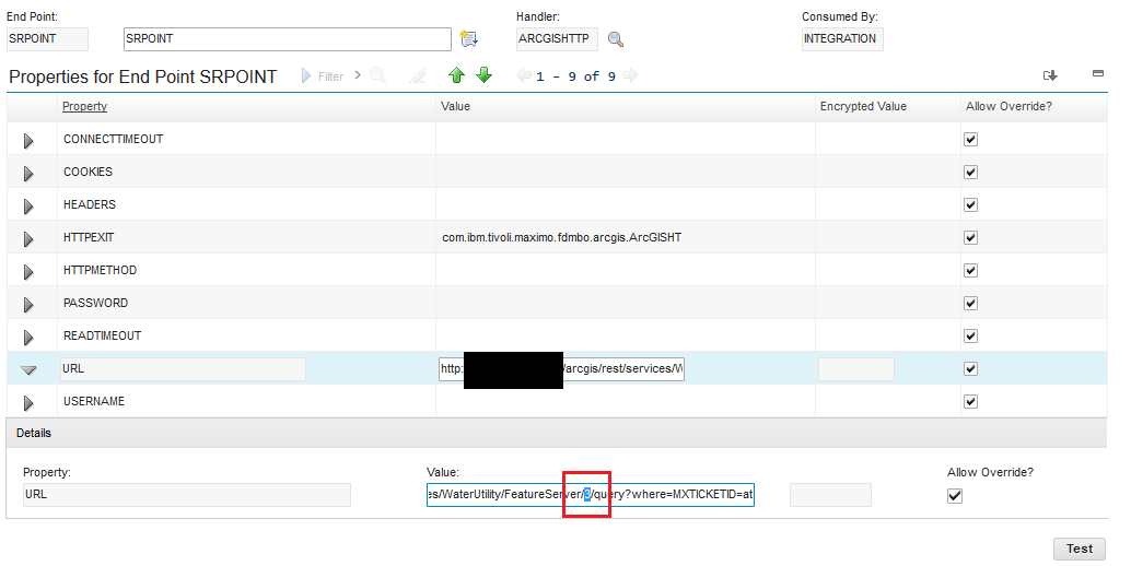

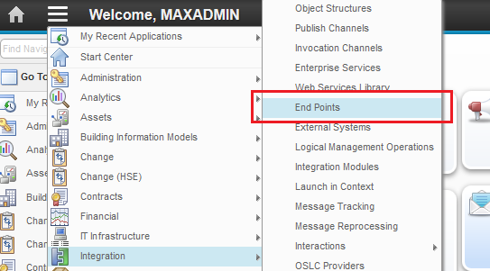

5. Go to End Points application.
6. Filter the records by the name of your GIS objects which had their layer IDs changed.
7. Open each one of them, update their URL values and save.
Example:
Old ID: http://<Map Service Address>/arcgis/rest/services/<Map Service Name>/FeatureServer/20/query?where=FACILITYID=attr:FACILITYID&outfields=*&f=pjson
New ID: http://<Map Service Address>/arcgis/rest/services/<Map Service Name>/FeatureServer/22/query?where=FACILITYID=attr:FACILITYID&outfields=*&f=pjson
Obs: just change the number that corresponds to the layer ID, don't change anything else.
