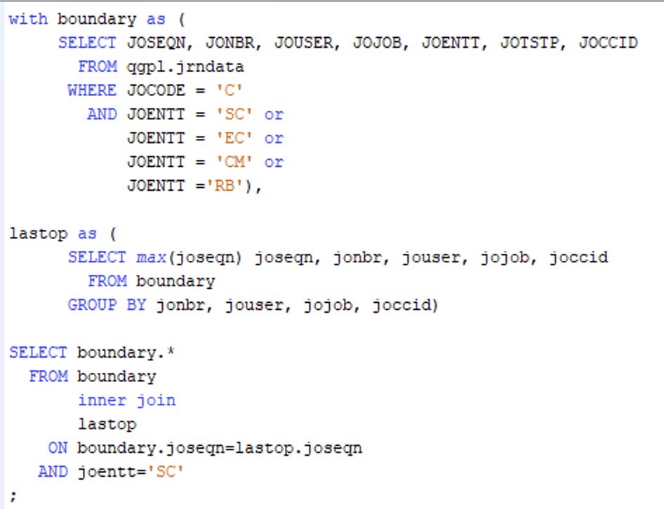

2.
Note that this SQL statement has two common table expressions.   You need to copy/paste the entire SQL statement.
with boundary as (
SELECT JOSEQN, JONBR, JOUSER, JOJOB, JOENTT, JOTSTP, JOCCID
FROM jrndata
WHERE JOCODE = 'C'
and JOENTT = 'SC' or JOENTT = 'EC' or
JOENTT = 'CM' or JOENTT ='RB'),
lastop as (
select max(joseqn) joseqn, jonbr, jouser, jojob, joccid
from boundary
group by jonbr, jouser, jojob, joccid)
select boundary.*
from boundary inner join lastop
on boundary.joseqn=lastop.joseqn and joentt='SC'
Screen print showing the entire SQL statement:
640271_complete_SQL_statement
3.This will produce a row for each job that has an open commit.
