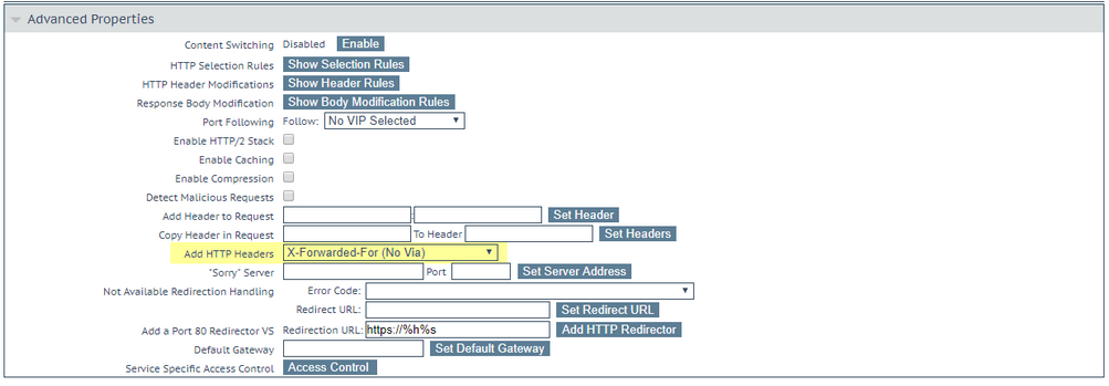

Kemp – Version 7.2.43.0.16425.RELEASE
For KEMP load balancers, we have observed that this Headers setting in your virtual services configuration will pass through the correct IP address. Other X-Forwarded-For settings such as the Legacy Operation (X-Forwarded-For) do not appear to pass through the real client IP correctly:

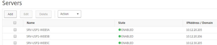

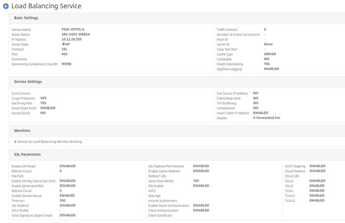

For NetScaler load balancers, we have observed that the easiest way to get X-Forwarded-For working is through a configuration as seen below. Please note that we took a fresh virtual NetScaler appliance and enabled the following basic features:
Add the Services:
Add the Virtual Servers:

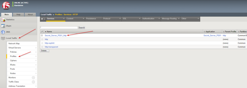

F5

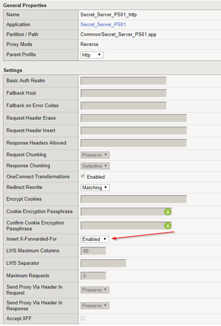

To add X-Forwarded-For to an F5 configuration, you simply need to ensure that the Local Traffic Virtual Server Profile is inserting it. To validate this, go to Local Traffic > Virtual Servers > Profiles. Then, select your Secret Server Profile:
Ensure that Insert X-Forwarded-For is set to Enabled:

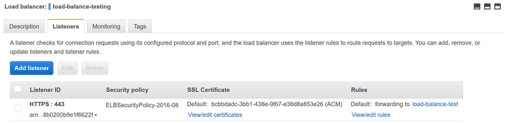

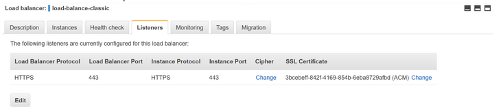

By default with Amazon ELB either Classic Load Balancer or Application Load Balancer configurations, X-Forwarded-For is included in the headers by default without additional configuration for HTTPS configurations. The listener configuration must be HTTPS. X-Forwarded-For will not work with a TCP listener.

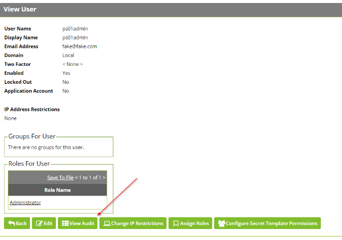

Verifying IP client IP address in Secret Server
The easiest way to verify that the real client IP is being passed to Secret Server after configuring these settings on both your load balancer and on the application side is to go to Admin > Users. Click on a user in which you logged in to the load balancer URL with. The, click the View Audit button on the individual user to see log in IP information:
The IP address in the the audit should reflect the real client IP. If it reflects a different address such as the load balancer's IP, this means there are problems with your configuration.
