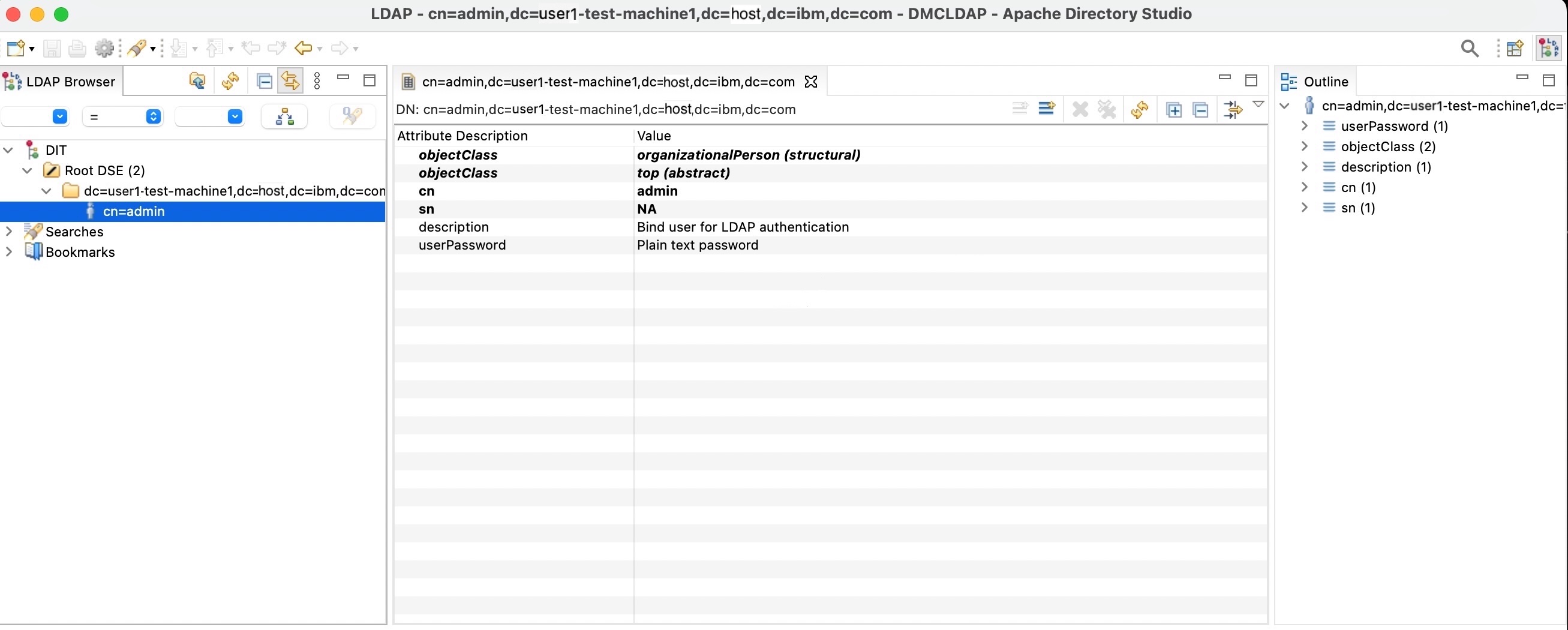

2. Create a Bind Account
https://www.ibm.com/docs/en/db2-data-mgr-console/3.1.x?topic=mapping-configure-ldap-user-information
Create an LDIF file for the bind account: bind_user.ldif
dn: cn=admin,dc=user1-test-machine1,dc=host,dc=ibm,dc=com
objectClass: organizationalPerson
objectClass: top
cn: admin
sn: NA
userPassword: bind_password
description: Bind user for LDAP authentication
Note: For this example, to view and manage the LDAP server, we are using Directory Studio.
Add the bind account to the LDAP directory:
ldapadd -x -D "cn=admin,dc=user1-test-machine1,dc=host,dc=ibm,dc=com" -W -f bind_user.ldif
Bind User
DMC configuration parameters :
Bind DN : cn=admin,dc=user1-test-machine1,dc=host,dc=ibm,dc=com
Bind password : bind_password

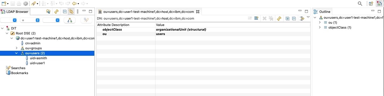

3. Create the Users Organizational Unit
Create an LDIF file for the users organizational unit : ou_users.ldif
dn: ou=users,dc=user1-test-machine1,dc=host,dc=ibm,dc=com
objectClass: organizationalUnit
ou: users
Add the users organizational unit to the LDAP directory :
ldapadd -x -D "cn=admin,dc=user1-test-machine1,dc=host,dc=ibm,dc=com" -W -f ou_users.ldif
User info : User base DN : ou=users,dc=user1-test-machine1,dc=host,dc=ibm,dc=com

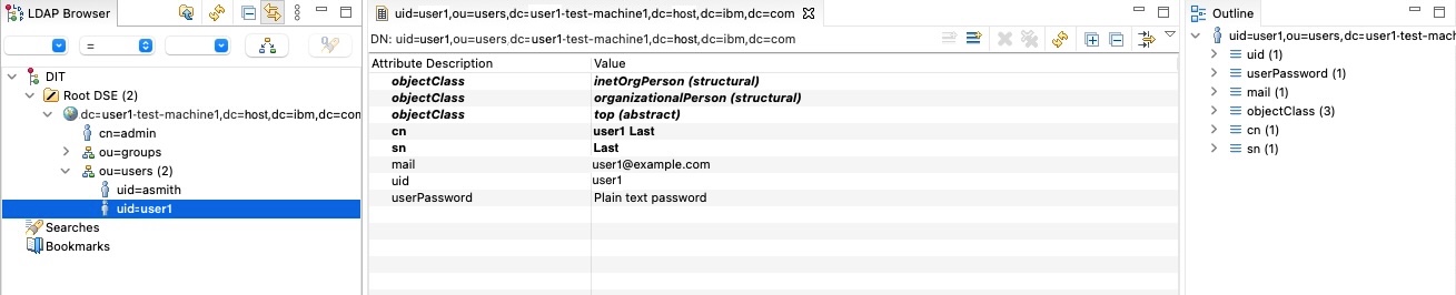

4. Add User Entries
Create an LDIF file for the users : users.ldif
dn: uid=user1,ou=users,dc=user1-test-machine1,dc=host,dc=ibm,dc=com
objectClass: inetOrgPerson
objectClass: top
uid: user1
cn: user1 Last
sn: Last
userPassword: password
mail: user1@example.com
dn: uid=asmith,ou=users,dc=user1-test-machine1,dc=host,dc=ibm,dc=com
objectClass: top
uid: asmith
cn: Abcd Smith
sn: Smith
mail: jsmith@example.com
Add the user entries to the LDAP directory :
ldapadd -x -D "cn=admin,dc=user1-test-machine1,dc=host,dc=ibm,dc=com" -W -f users.ldif
User entries
User info : User login attribute type : uid

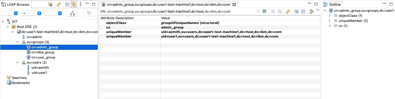

5. Create the Groups Organizational Unit
https://www.ibm.com/docs/en/db2-data-mgr-console/3.1.x?topic=mapping-configure-ldap-group-information
Create an LDIF file for the groups organizational unit : ou_groups.ldif
dn: ou=groups,dc=user1-test-machine1,dc=host,dc=ibm,dc=com
ou: groups
Add the groups organizational unit to the LDAP directory :
ldapadd -x -D "cn=admin,dc=user1-test-machine1,dc=host,dc=ibm,dc=com" -W -f ou_groups.ldif
6. Create Groups in LDAP
Create an LDIF file for the groups : groups.ldif
dn: cn=admin_group,ou=groups,dc=user1-test-machine1,dc=host,dc=ibm,dc=com
objectClass: groupOfUniqueNames
cn: admin_group
uniqueMember: uid=user1,ou=users,dc=user1-test-machine1,dc=host,dc=ibm,dc=com
uniqueMember: uid=asmith,ou=users,dc=user1-test-machine1,dc=host,dc=ibm,dc=com
dn: cn=dba_group,ou=groups,dc=user1-test-machine1,dc=host,dc=ibm,dc=com
cn: dba_group
dn: cn=user_group,ou=groups,dc=user1-test-machine1,dc=host,dc=ibm,dc=com
cn: user_group
Add the group entries to the LDAP directory :
ldapadd -x -D "cn=admin,dc=user1-test-machine1,dc=host,dc=ibm,dc=com" -W -f groups.ldif
Adding members to group
Console Administrator : Group DN : cn=admin_group,ou=groups,dc=user1-test-machine1,dc=host,dc=ibm,dc=com
Console Administrator : Member attribute type : uniqueMember
Console Administrator : Member attribute type : dn
Note: The steps above shows the configuration for the DMC Console Administrator group only. Repeat the same steps for DMC Database Administrator group and/or DMC Database User group as needed.

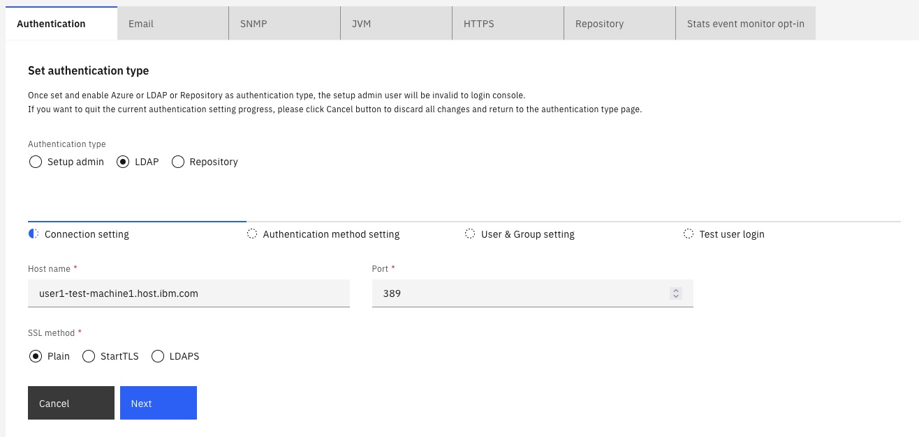

7. Configure LDAP on DMC like this.
Host name : user1-test-machine1.host.ibm.com
Port : 389
DMC LDAP

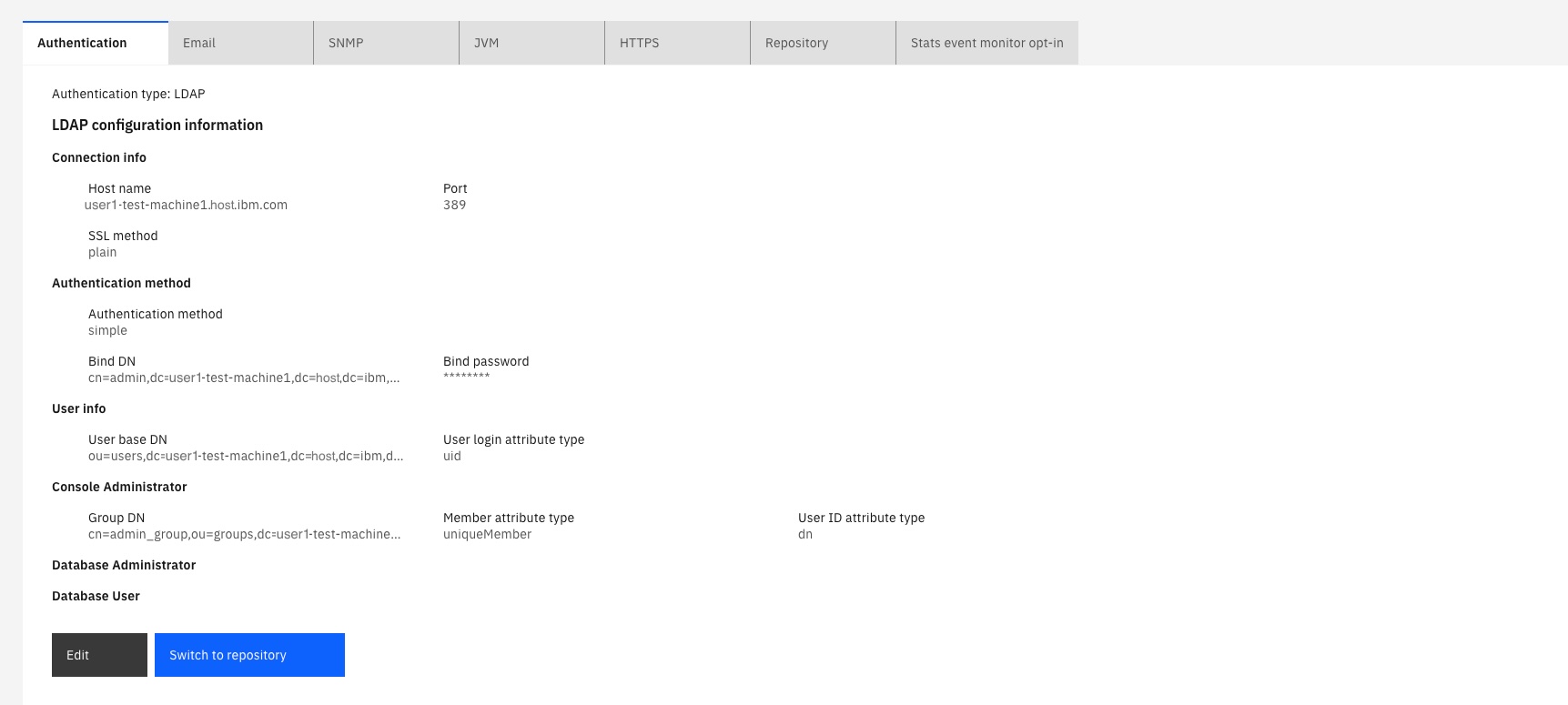

Bind
DMC Groups
LDAP Summary
