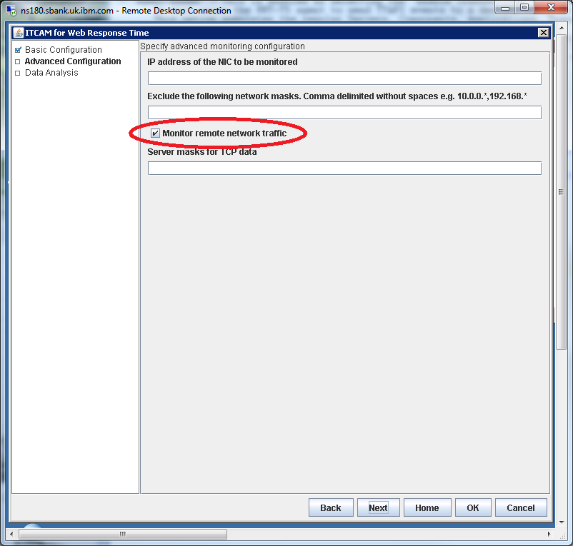

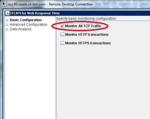

3.1 WRT is configured in AgentLess mode as seen in the 2 following screen captures :
The 'Monitor All TCP traffic' option is selected/ needed for Agentless mode.
The 'Monitor remote network traffic' option is selected/needed for Agentless mode

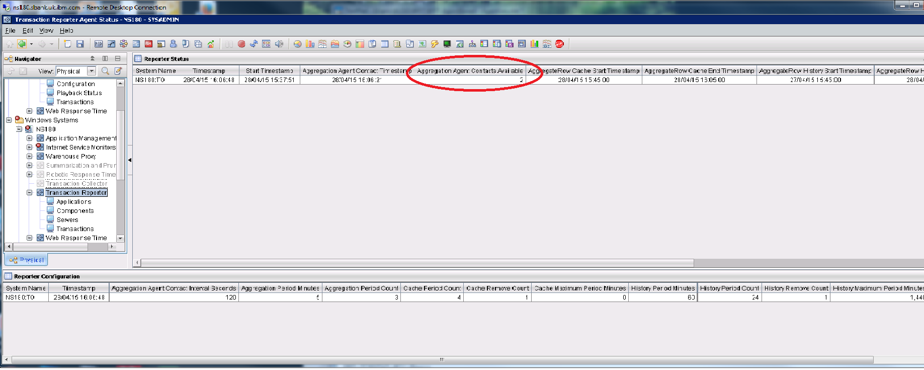

Tx Reporter Status view:
If If you have for instance 2 WRT agents configured in agentless mode and installed in your environment,
the field 'aggregation Agent contacts available' field of Reporter Status view should report the right number
of agentless agents.
In my test environment, I had 2 WRT agent in agentless, hence the value of "2" in 'aggregation Agent
contacts available' column.

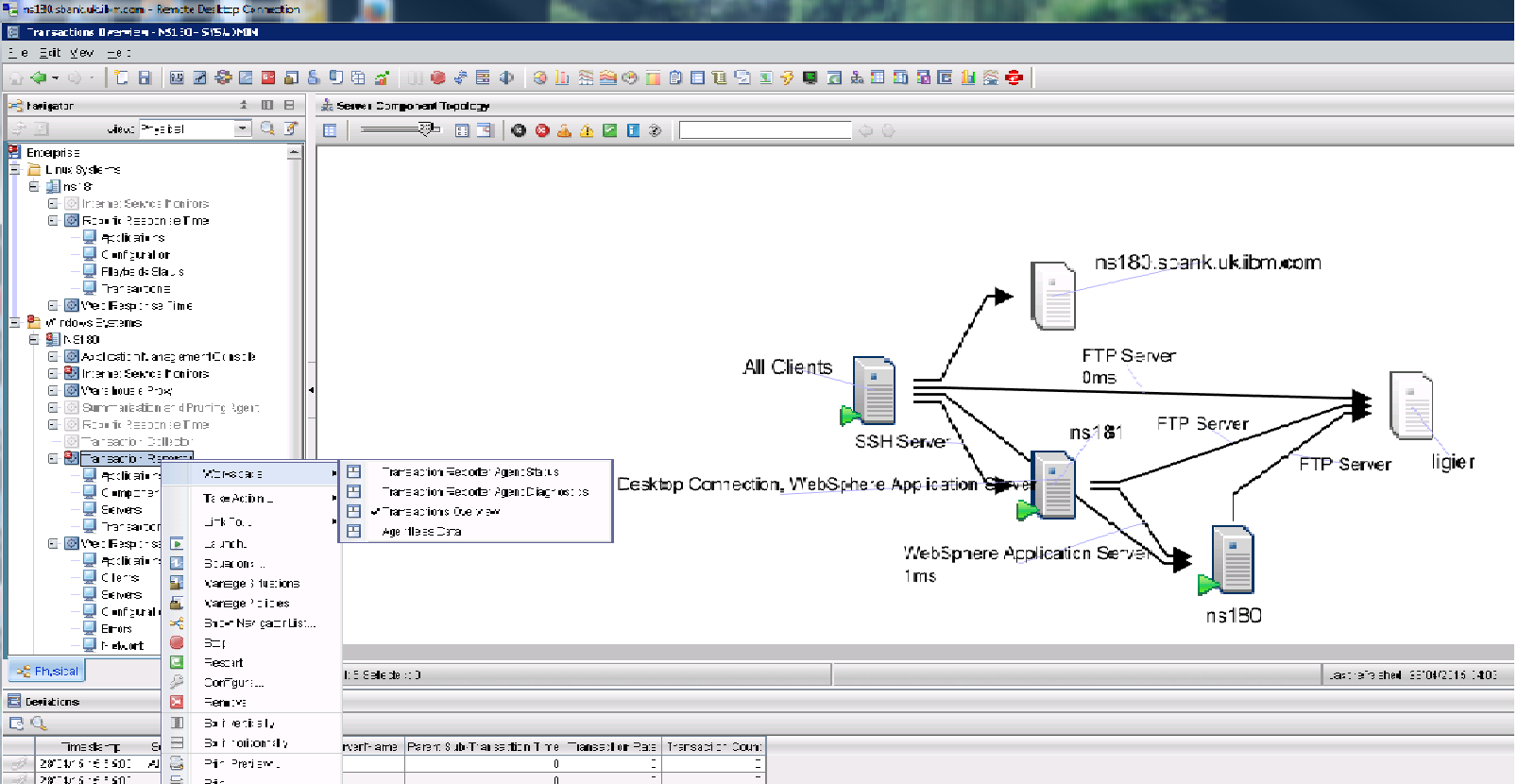

Tx Reporter Overview view:
Tx Reporter -> Workspace -> 'Transactions overview' should report data in the Server Component Topology view

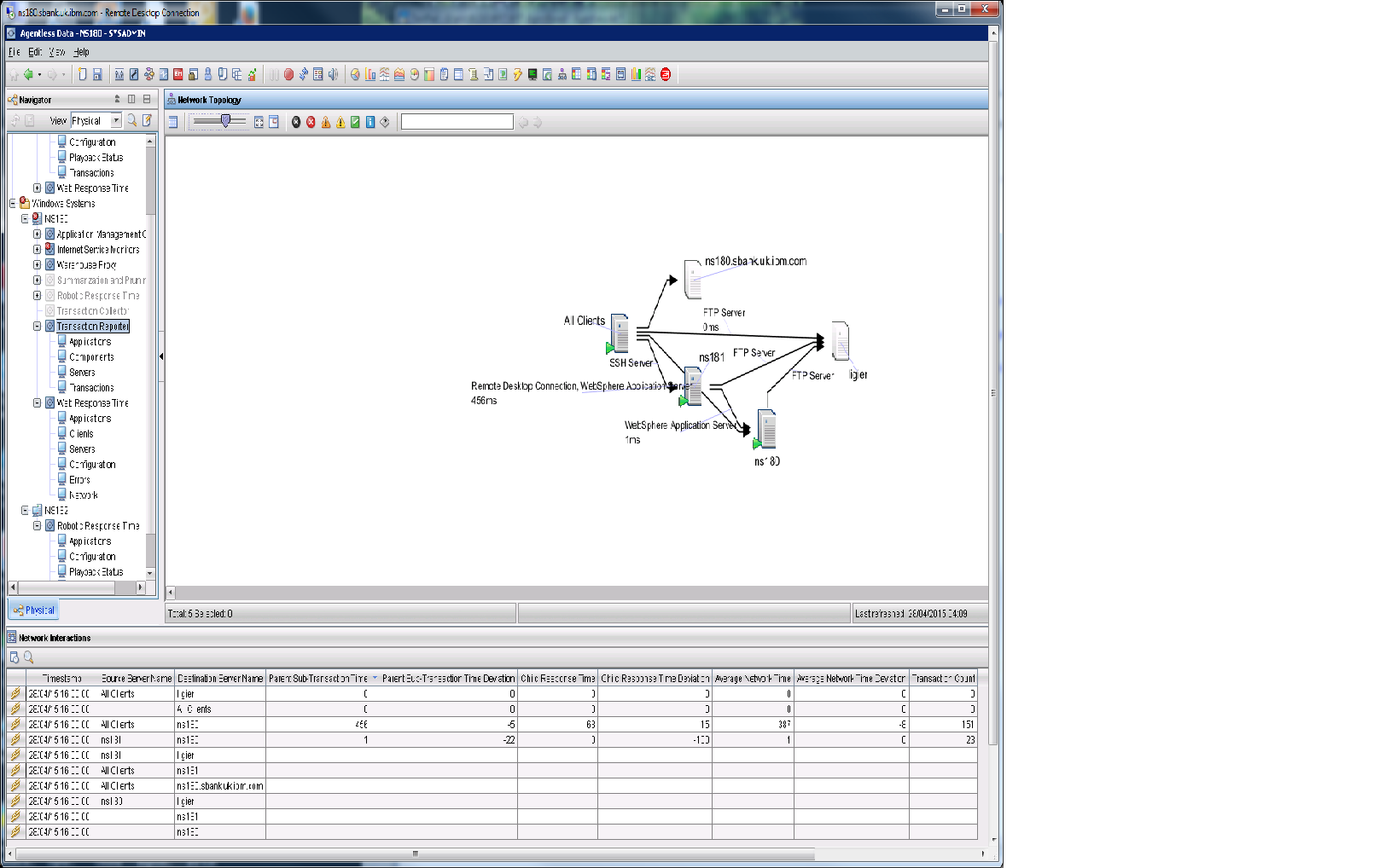

Tx Reporter AgentLessData view:
Tx Reporter -> Workspace -> Agentless Data should report data in Network Topology view
